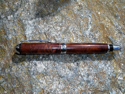

Haven't posted in a while ...
This fulfilled my very late PITH commitment, a Sedona in Redwood Burl
And a couple of slimlines made from scrap lumber designated for the dumpster.
Spalted Cherry Burl dressed in Copper kit.
Pic is lousy but you'll get an idea of the grain in the Black Walnut Burl in Gold

Nice, the slimlines look like they are one piece. How do you engage the transmission to reveal/hide the refill?

You just twist the nib.
Two excellent tutorials here. One by Don Ward and the other by Bob Altig.
I just followed their journey and modified it for my purposes.

RON, those are some really nice pens. Great pictures also. The wood is really beautiful. I didn't know you had it in you!:biggrin::rolleyes:

Nice pend Ron, the Sedona is very nice, but the Cherry burl and the walnut are great.
Thanks ... both the cherry and the black walnut were free wood.
One of the neighbors works at a place that supplies cabinet shops with wood and these were 4 x 4's that the lumber was shipped on.
All of them are heart wood so you don't know what you have until you start cutting it.
Another neighbor makes furniture in his garage and 90%+ of the wood is straight grained and that is what he wants but the other 10% is where I get mine from.
