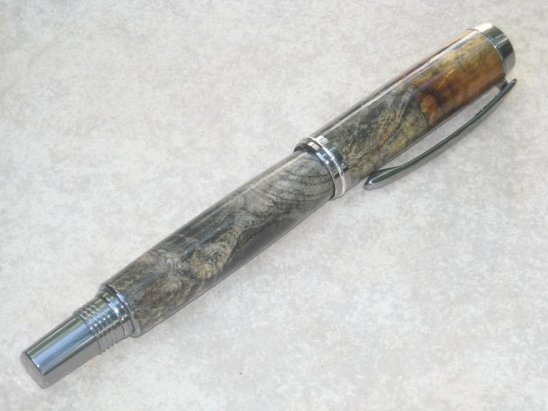

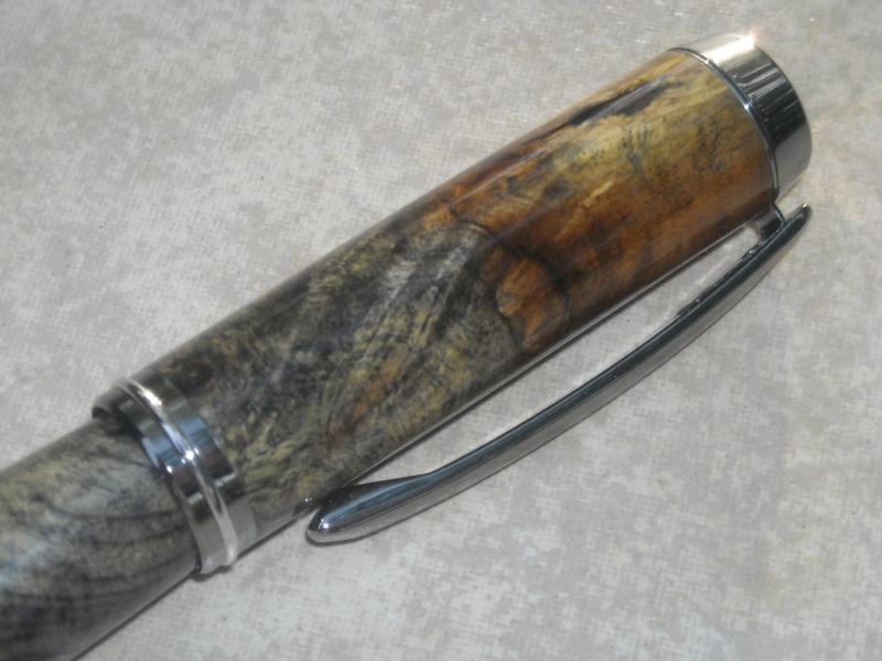

Chuck, I read your message and got inspired. Here is a Jr Gent turned from one of blanks you gave out. Just completed it a few minutes ago. I had to stabilize the whole blank and I had to fill a few spots in the cap with epoxy and CA with shavings. I really happy with the way it turned out. I'll bring it to the next meeting for a closer review! CA finished with about 8 coats using the William O Young method. Then Novus 2, Hut Ultra Gloss, and Ren Waxed. Just took a quick picture on the patio table. Thanks a lot!

Nice pen Ron. I just started turning one of Chuck's buckeye burl blanks myself. Also going to make one from the amboyna burl of his. Looking forward to see it at our next meeting.

Ron , you've just confirmed my accusation . You did a great job on that pen . I like that style of pen . It's classy , and compliments the wood . Thanks for sharing it with me . :good::good:
