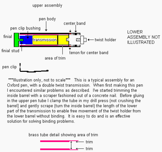

I would like to pass along some details about how I resolved the tight fitting lower barrel and hard to twist problem with this style of pen. This has worked out well for me.
<br />
I hope this helps. IAP is a great place!
Bozz in Fair Oaks, CA
