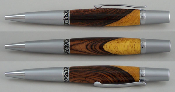

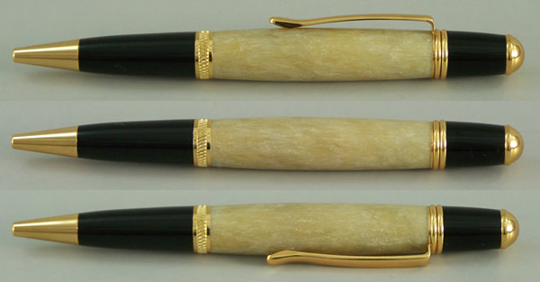

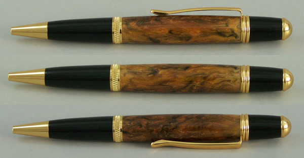

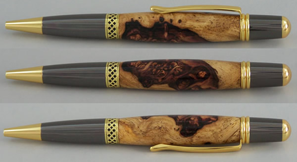

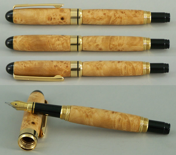

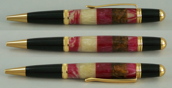

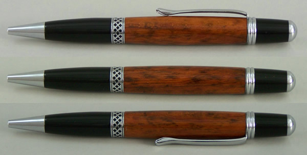

Pens from this week:
1-3. Resin blank that I got from Victor (LandfillLumber).
4. Euro Fountain Screwcap from woodcraft in Maple Burl.
5. Honduran Rosewood
6. Snakewood
7. Cocobolo w/Sap

The resin blanks have been MM to 12000 and the others have 2 coats of thin CA, 4 coats of medium CA and then MM to 12000.
rsjimenez
Nov 28, 2010
422
Alvin, TX
Very nice group how easy is it to do the segmented resin blanks?Thanks for sharing,Victor
I was easy. Square the full blanks before cutting to tube lengths to make sure all the cutoffs are squared and then put all the cutoffs together with Thick CA on one side and Accelerator on the other.
