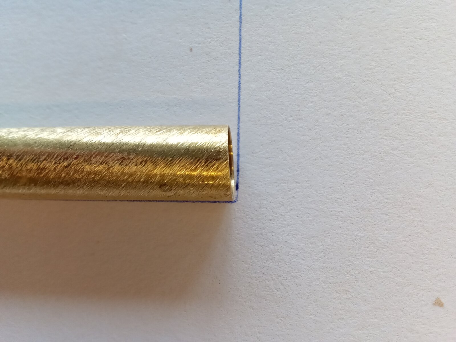

About a week ago I called Penn State Customer Service for assistance with a pen kit that had a defective brass tube.
You can see the situation I believe in the picture below. Normally I would have just squared off the tube and moved on except it would be too short according to kit specs after squared up.
