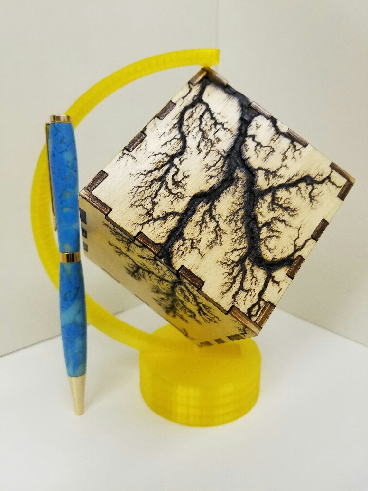

I didn't realize this blank was partially clear. You can see the brass tube, however it turned out nice, I thought, with the gold pen parts.
However, that does lead me to ask some questions.
What type of paint do most of you use to paint the tube, or inside of the blank? Will Testers model paint work?
Which is better, paint the tube or the blank or both? I feel that if I paint the tube, I may still be able to see the adhesive. Does the paint effect adhesion at all?
Thanks!
Edgar
