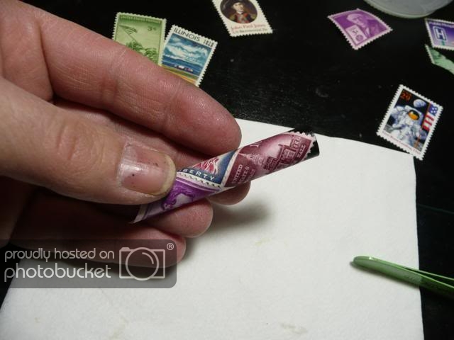

Hi all, according to the processes carried out in this case I will begin the detailed process step by step realization of a pen with stamps imported from America and I live in Spain I had to buy the stamps on ebay. If someone tells me where I can put a tutorial in the forum will be happy to do so.

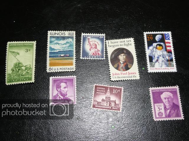

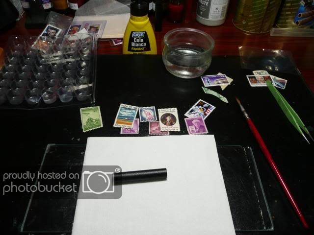

We begin by selecting the stamps for our pen

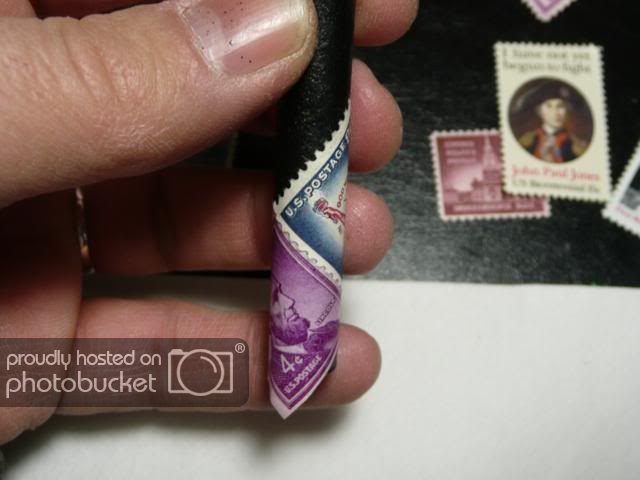

Once selected proceed to go sticking stamps one by one in the tube. The brass tube to be having problems with the glue, we solve painting the tube in my case I have painted black

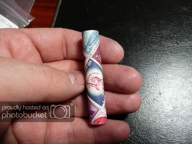

Make a mixture of white-tailed 80% and 20% water to affix stamps, adding a small amount of water ensures that the seal is not sticking instantly

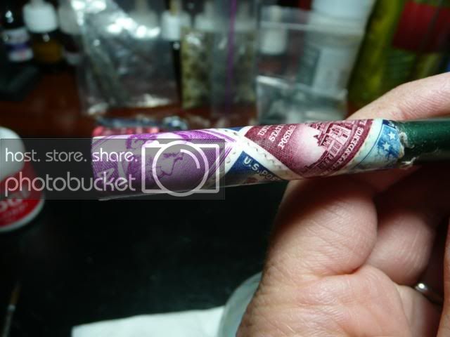

We started to hit all the stamps in my case I hit the diagonal and one must be careful to not see any black color space, we must have patience patience .....
Little by little we are moving forward, until the final result
now our pen is ready for casting polyester resin, soon will put the rest of the pictures of the process, a greeting from the south of Spain

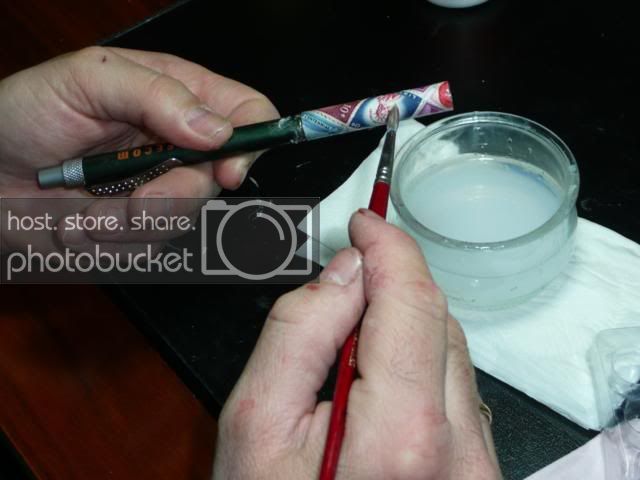

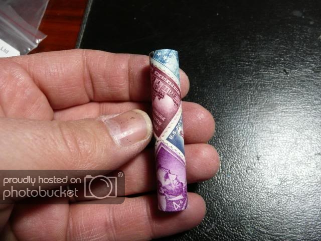

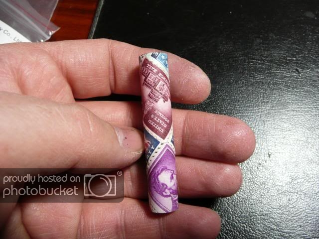

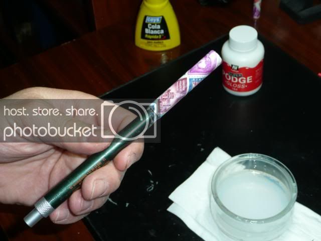

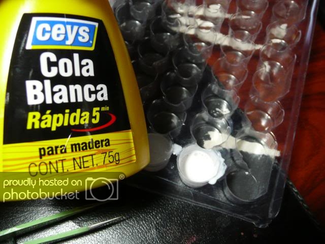

Hi all again, as our friend its_virgil I will be putting the names of the products I use, remember that I live in Spain and almost all products are purchased in my country other than those which are imported. I also want to ask a little patience and I have not much time to make pens I work as a professional audio installer car audio and stage and am often working away from home.
The glue used to affix stamps white carpenter's glue is very good and totally transparent when dry, it is best that you can mix with water that is not as dense.

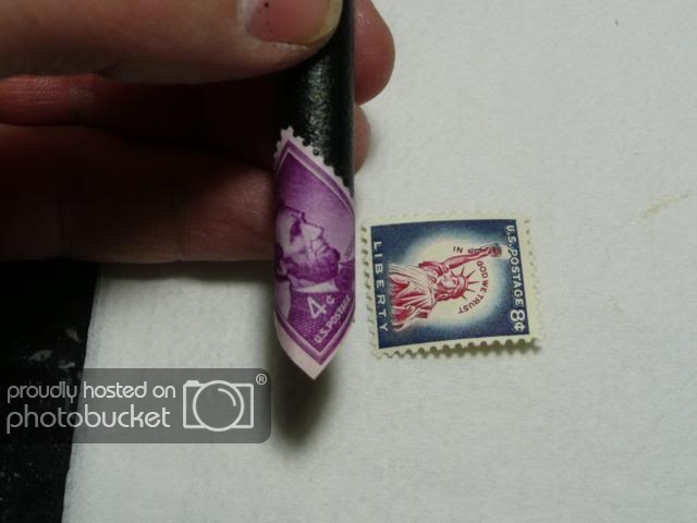

The process is to paste stamps one by one and if possible on the diagonal since it is much better, to avoid getting a stamp and other areas are where you see the color of the tube to that mix white glue with a little water With this we got the label does not stick right away and we can move it for about 10 seconds to put in place without problems.
I also tried the Mod Podge, I personally do not like much since it is not completely smooth and can sometimes be a little blank spaces, the best thing for me is d cyanoacrylate glue.
Reference COLA BRAND WHITE CEYS.

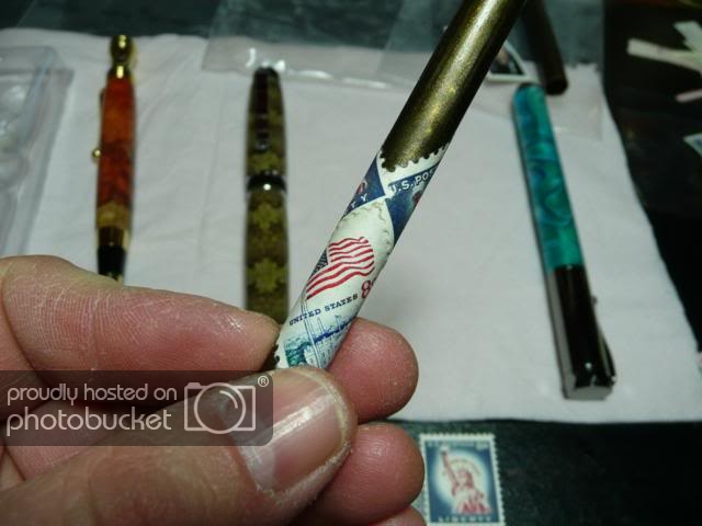

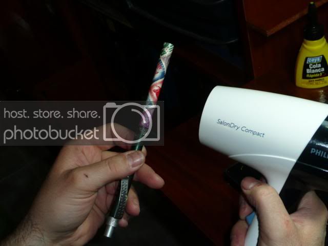

Hdtran Hi, how to paint the pipe is as follows, I use black spray paint for ease of application, with a very thin layer of paint to avoid unnecessary accumulations.
A good trick to avoid damaging the seals is as follows, apply a thin layer of white glue with water on the seal, the coating must be very very thin to prevent the seal when pasting white-tailed beast protrude and can stain the rest of stamps and glued.

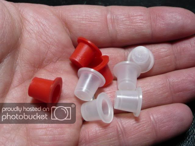

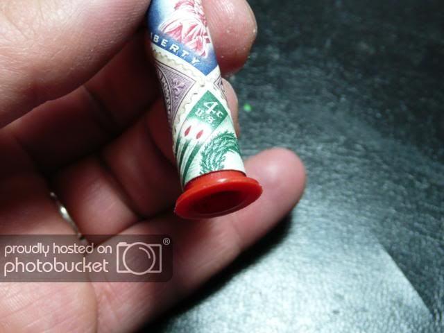

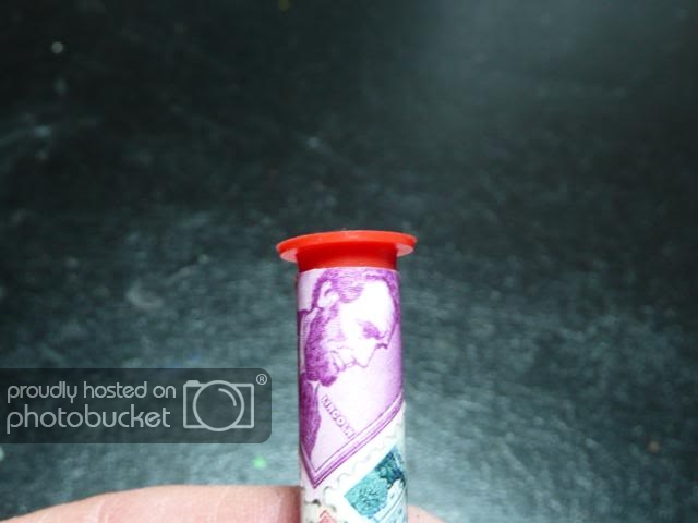

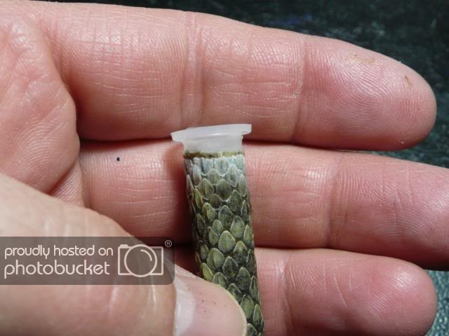

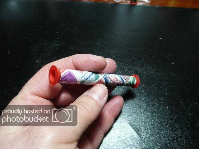

continue .... once the bonding process seals the tube prepare for casting polyester resin.
To fill the holes in the tubes I use a conical plastic plugs that fit perfectly into the holes.
plugs to be of conical form not necessary to glue the tubes but I usually put some white glue it but this time without water to completely seal any small hole through which the resin can be filtered and so damage the tube.
I advise to never use caps to glue cyanoacrylate adhesive such as glue to dry I can bleach the area of contact, put a photograph shows the area where it can be bleached, cyanoacrylate, so I use white glue because it never whitening is completely transparent.

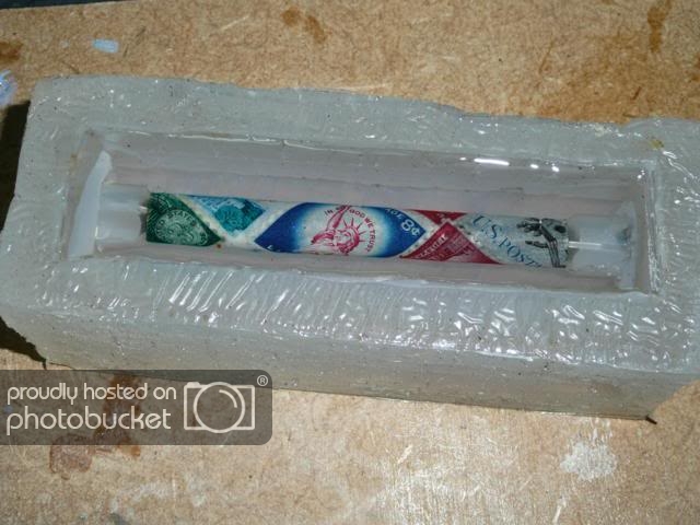

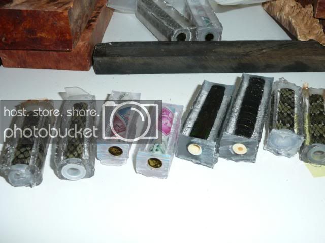

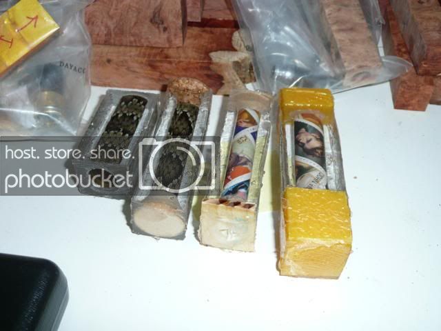

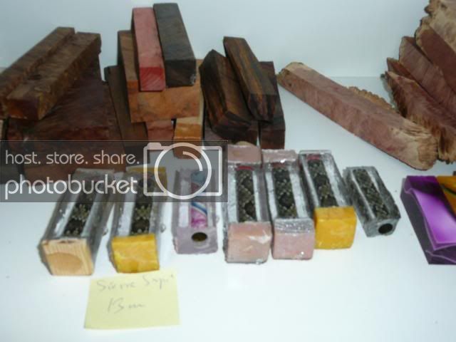

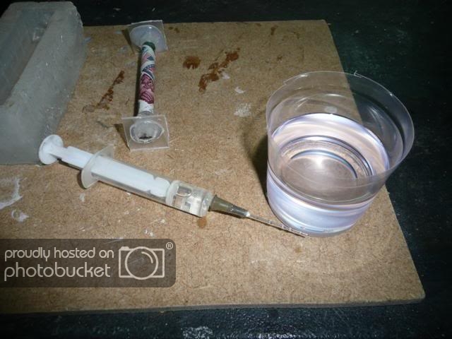

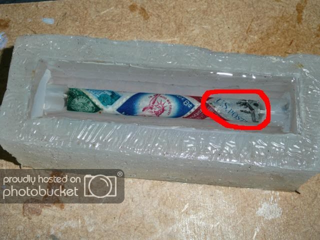

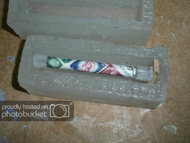

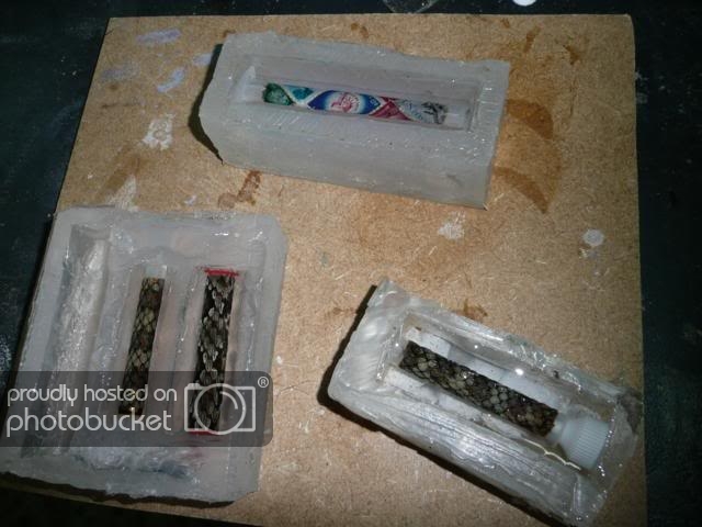

Once the tube tightly sealed with plugs prepared in silicone molds for casting polyester resin.
The resin I use is Dow Corning brand, and is completely transparent, with the passage of time turns yellow and remains the same as the first day, the proportion of catalyst is 2% at room temperature of 20 degrees Celsius in 18 hours is manageable.
In the picture you can see totally transparent resin and catalyst in the syringe ready for mixing
Very slowly pour the resin and to avoid creating air bubbles to avoid future surprises, once I put the resin poured into a mold lunchbox kitchen that has a valve at the top of the lunch box and extract a small air pump interior, it gets out all the little air bubbles that may contain the resin mold, the mold will keep it in the lunchbox for about 5 minutes.
After I put the silicone mold to air dry for about 18 hours. This is the look after the lunch out of cooking and remove air from the mold.

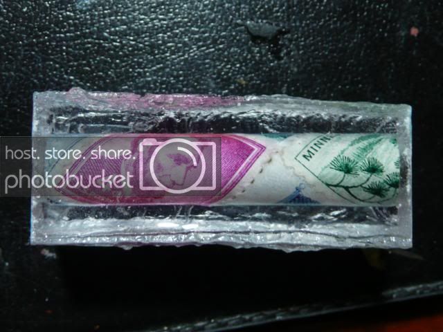

I find a problem by pouring polyester resin to filtering in the stamps and have been wet and evil.

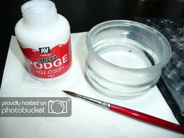

I've solved the problem by applying to the Super Podge gloss labels before applying the polyester resin
podge made a mixture of water and 80% + 20% and give a pass with a brush around the base of the seals, to keep a little water does not dry as fast pogde thereby avoid small scratches that can come out, Once the entire surface with podge use a hair dryer to speed drying and prevent water from seeping into the seals and we will do the same.
do 5 to 6 applications with the super podge, it is this aspect once the process, and ready to make a polyester resin casting without fear that the same thing happen to us.

also usually put these caps on the ends of the tubes to prevent the polyester resin from within them, can be found in hospitals are used to measure the temperature in the ear.

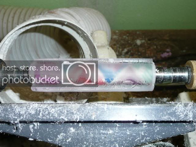

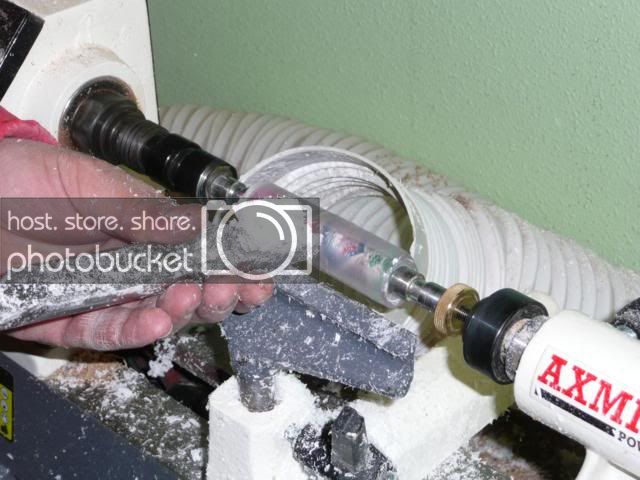

We have prepared all cast polyester resin to start turning.
On this occasion we pen turning ZEN model with U.S. stamps, purchased on ebay and imported to Spain.
with great patience and go slowly turning the polyester resin with the gouge and giving the desired shape.
Greeting.
Alfonso
Jan 31, 2011
23
Cehegin-Murcia-España

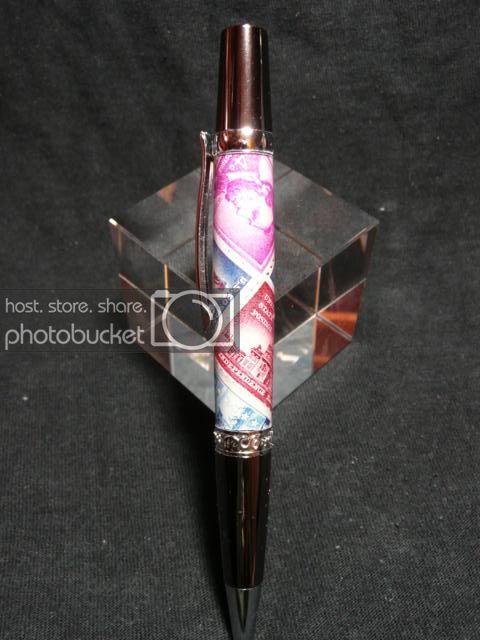

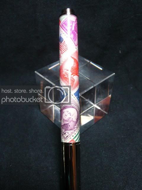

Well friends this comes to an end, once turning, sanding with sandpaper from 320 to 1200 and then with micro mesh of 1500 to 12000 dipped in water and then polished with HUT Ultra Gloss Plastic Polish, and this is the final aspect.
I hope this tutorial is helpful and you enjoyed with him.

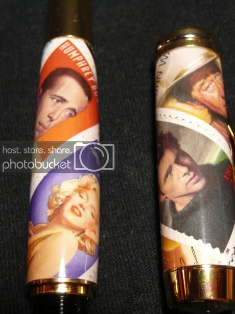

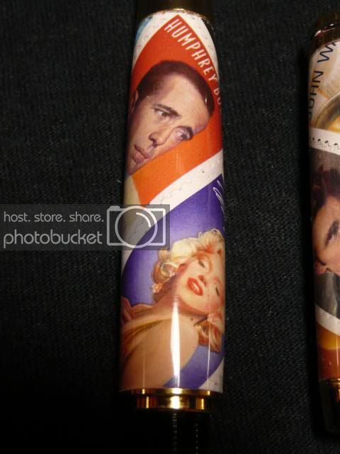

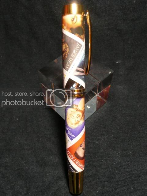

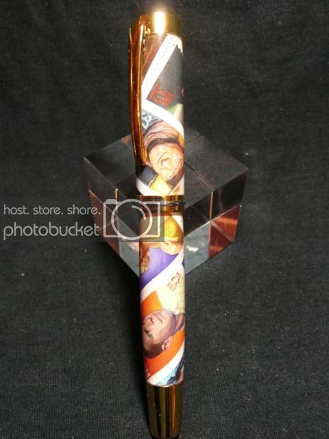

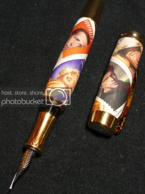

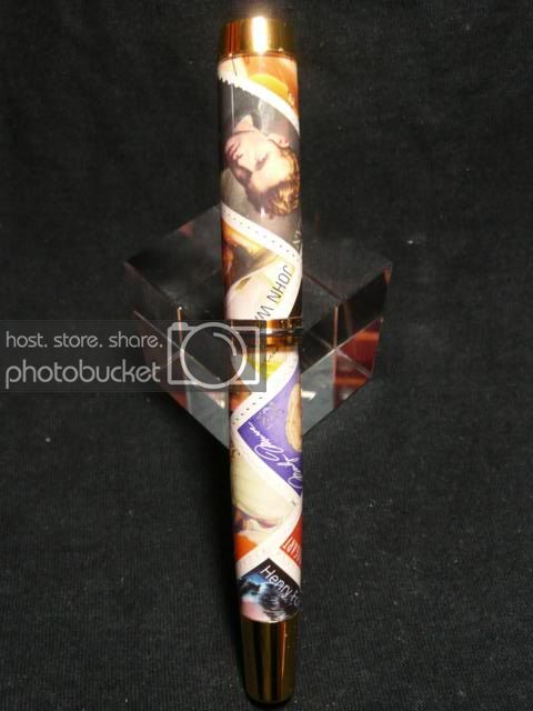

Hello friends here send the latest pictures of pens and pen turned with seals.
saw models
Title Legends of Hollywood stamp made ​​with Hollywood actors
Greeting.
