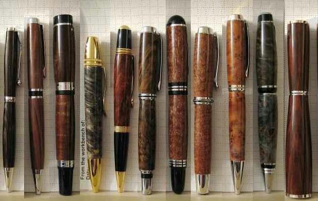

Chuck Key
May 3, 2005
1,596
Richmond, Virginia, USA.
By weight l to r.
