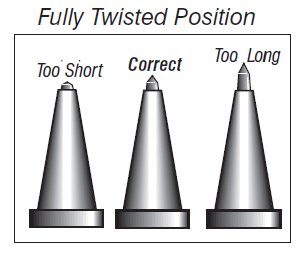

Here's a simple graphic taken from a set of instructions:

I preferred it to protrude more than what was recommended because I write on a steeper angle than most. However, I since have become accustomed to a length as pictured above under "Correct". I didn't find my longer ones to sell any less than my shorter ones. As stated above, just make sure the nib hides and protects the refill when retracted. I like to allow some breathing room in case a client want to it protrude more. I haven't had much success removing transmissions without damaging them. FWIW. Good question.

What looks good to you should be the primary factor. Like Tony I find the "correct" position too short. I will go little farther out than that while ensuring I get full retraction. Hey its not rocket science here folks. As with most things to do with pen making/turning there is no definitive right or wrong.

One of the best things about the Cross-style refill is its flexibility. It can be adjusted by the user to each individual's perfect degree of stick-out-ness.
The refill screws in! Press the transmission in so the refill would extend to Brian G's diagram's "too far" level. Then unscrew the refill a partial turn to match the "correct" position.
