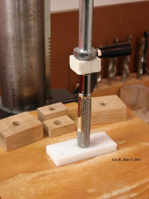

I've assembled all my pens on the lathe. Simply turn a couple of MT2ish tapers on some hardwood and make sure the big end is square. I used an old plastic cutting board for protective tips--just epoxy them on. When the tips get chewed up, just re-face or replace. Works great for free.

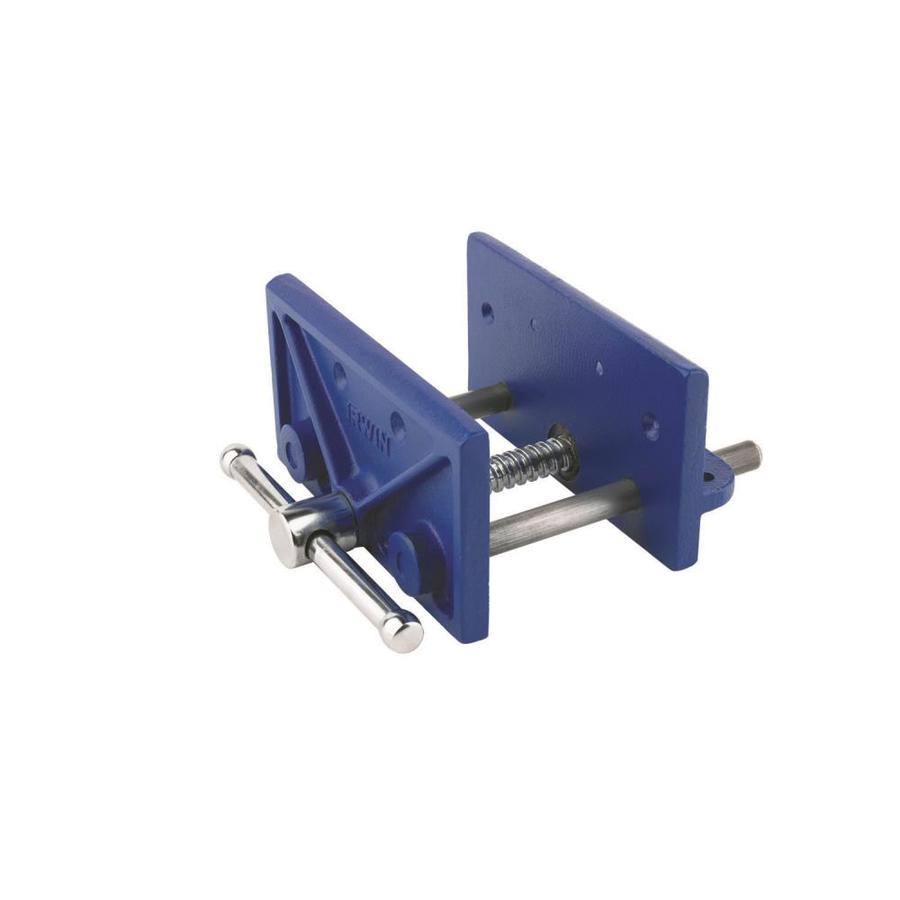

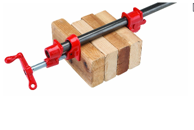

I usually use one of PSI's, but have also used a woodworker's vise, bar clamp and the lathe. All work equally well, just a matter of personal preference.

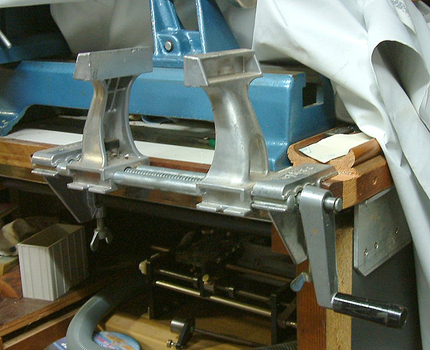

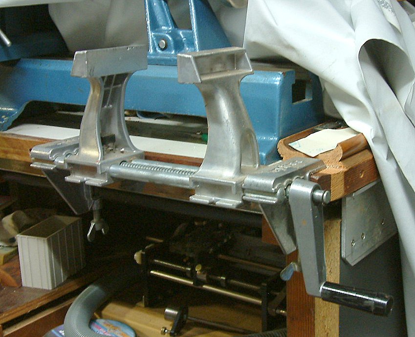

Love, love, LOVE the Milescraft! Quality construction. Easy to use. I just clamp it to the bench when I need it. Russ

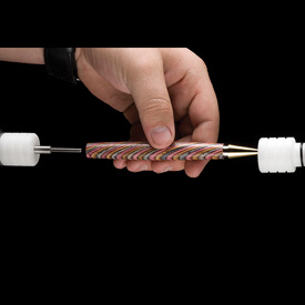

This is what I have used...
...and it does everything I need. It has a pin on one end that keeps the blank centered (and it can be removed when needed). It fits into the Morse taper, one part on the head stock and one part on the tail stock.
Craft Supplies Artisan Pen-Ultimate Assembly Tool
Part# 1027970001 $19.95
