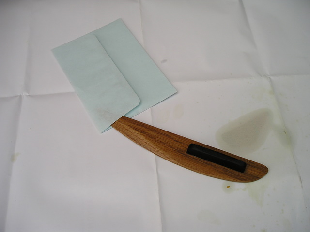

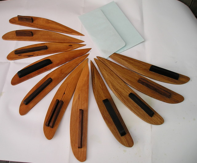

Michael, I have designed and made my own letter openers made out entirely out of WOOD (white oak, cherry) with exotic wood accents.
Match existing woods used for your pen/pencil set and make a nice letter (wood) openerer to complete your set.
