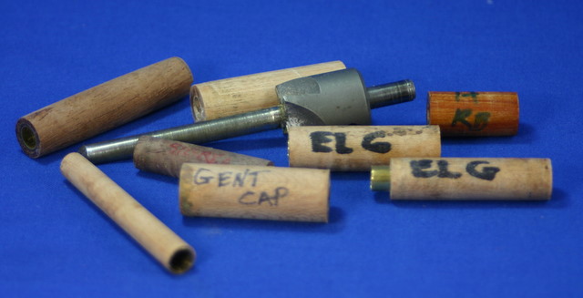

Make yourself some shims for each tube size. Here what I do: drill and glue in a 7mm tube in a scrap of wood. Turn the scrap so that the kit's tube to be used will just slide over the newly turned shim. I get really close with tools and finish the sizing with sandpaper. I only have one pen mill with the 7mm shaft. The fit must be very very close or you will get those marks you described. They are caused as the cutter head wobbles because of the wrong size pilot shaft. I've attached a picture of some of my shims.
Also, not many will agree and I may be one of the few who think so, but a pen mill is a hand tool. Make a handle for it. You should be cutting the blanks so that the mill used in a handle will do the job quite adequately.
