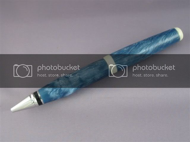

I have made a few pens over the years for special people, non more satisfying than for those who have challenges.
One thing I have lernt is to get the grip right for them. I will ask if they can take some clay and roll it up, then hold it like a pen. I ask them to press into the shape thier writing grip. I then get the diameter of the grip and us ethat measurement to style teh design of the pen.
This pen here is one I made for a beautiful young lady with CP.
It's a cigar kit that I played around with, her favorite colour is blue.
I think what ever kit you choose that they will like it, incorperating something personal like a favorite colour makes it extra special.
