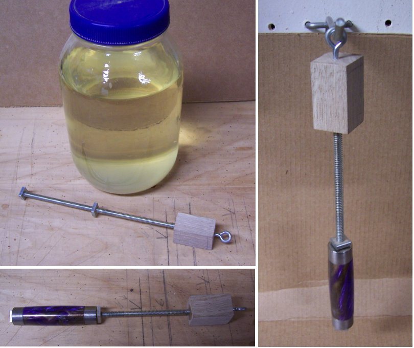

Since it is semi-relevant to the thread, for anyone interested....
Here is one way to "dip n drip" blanks.
Start with a 3/16" or similar size all-thread, which you glue into a small wood block (your least favorite pen blank will work) and screw an eye bolt into the opposite end.
When the blank is ready to finish, just thread a nut onto the rod and slide the blank on WITH the bushings still intact. Thread on a lower nut to hold the blank in place then dip the blank into a container of finish then S L O W L Y withdraw the rod to keep air bubbles off of the blank. I use a pegboard hook to hang the rod while drying but anything would work. After the finish tacks, remove the blank and reverse it then repeat the dipping process. I usually put at least 4 coats on.
The reason you leave the bushings on is that when the finish runs down the tube it will want to bulge at the end. With the bushing still attached, the finish runs beyond the end of the blank and will bulge on the bushing instead.
I keep another jar of thinner and toss the bushings and all threads in to clean off the finish.
To use this method, obviously you will need more than one set of bushings BUT you can make your own from any material.
Credit for this idea goes to Lyle Walden who showed me how to do it.
Here is a photo of what I am talking about...
