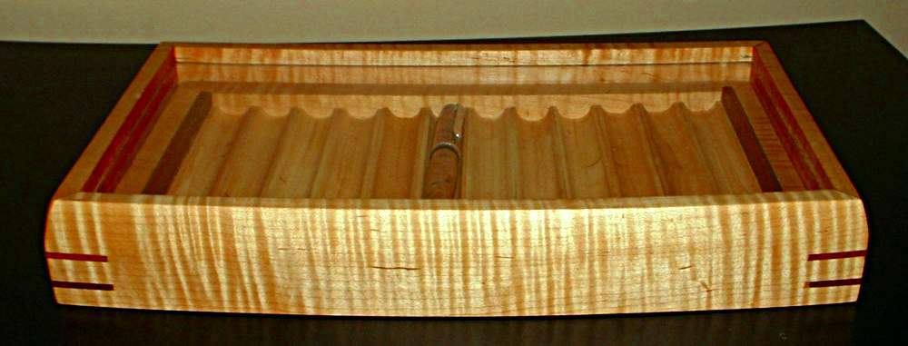

Here's a poor photo of a single-tray case.
http://www.penturners.org/photos/images/3231/1_curlyMapleCase2.jpg
The case is mitered and the horizontal contrasting bands are known as slip-feathers and are splines running through the joint.
Mitered joints may hold ok by themselves but the spline provides more and a better glue surface.
Glued miters are end grain only and don't always hold well.
The spline provides a larger and face-to-face grain surface increasing the joint's strength.
