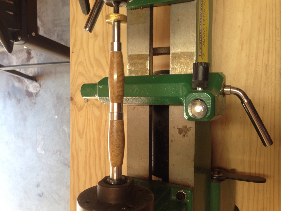

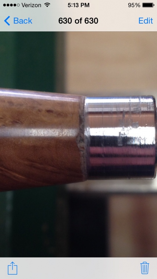

Hi guys. I'm in the process of turning 10 cigar pens from brown mallee burl. The first blank (as pictured), is giving me trouble. Both ends of the blank that are facing the tailstock have small tearouts right where the bushing meets the blank. The sides of the blank that are facing the headstock are perfectly fine. I tried filling the small gaps with CA.
I have turned brown mallee before in a slimline and it turned out great. I'm thinking this is a technique issue maybe? Just seems to coincidental to me that it's on both ends facing the tailstock. Also, this occurred before I stated using my skew.
Any help is greatly appreciated!

It may be deceiving from the pic, but it looks like that little of chip out could be cleaned up by hitting the blank/tube against the sanding disc. I cant really tell if it would make a difference, but it looks like it would be OK. As to why it's happening, if your wood has even the tiniest tendency to chip, right on the edge at the end of turning is where it will happen!
Good luck!

I agree with Dan, but I'd add, "How are you squaring the blanks?" IF you are using a pen mill, this could be tearing out some material, too.
Soak the ends with thin CA, before squaring. Makes squaring more difficult, but less likely to chip out. OR, don't square them, then when you reach this point in turning (nearly the size of the bushings), you can take them off the lathe and sand the ends down to the brass tube level. That part will not be chipped out. THEN add some thin CA to the ends, let set overnight, touch to the sander to re-square and turn to final diameter. This also helps, if you are making a sierra, since the end is rotated against the front end of the pen to operate it. If it is CA reinforced, it is less likely to chip out with use.

...what Ed said. Also, it is very important that you are using a sharp skew. A dull tool will cause tear out because you are pushing the wood versus cutting it.

Are you cutting towards the tailstock? I found when first starting turning pens, that this was my problem. Something else that might cause this, is insufficient glue at the ends, sometimes its a fault in the wood, I've had this also, as others have said, dip the end in thin CA to rectify the problem.

I am using a carbide barrel trimmer (pen mill) to square the blanks on my drill press. I am turning the blanks from headstock to tailstock, which is why I thought it is possibly a technique issue, since it's occurring at both ends that face the tailstock. I've only turned roughly 75 pens, but have never had this issue before. I'm focusing more on burl woods now, so trying to hammer this down. This blank was not stabilized, but the rest of the burls I have are.
I will definitely go the thin CA route as mentioned.

To me looking at the photos of what to OP shown the problem started with the mill. It could have fractured the blank and it shows up when it is turned down. Again just my opinion.

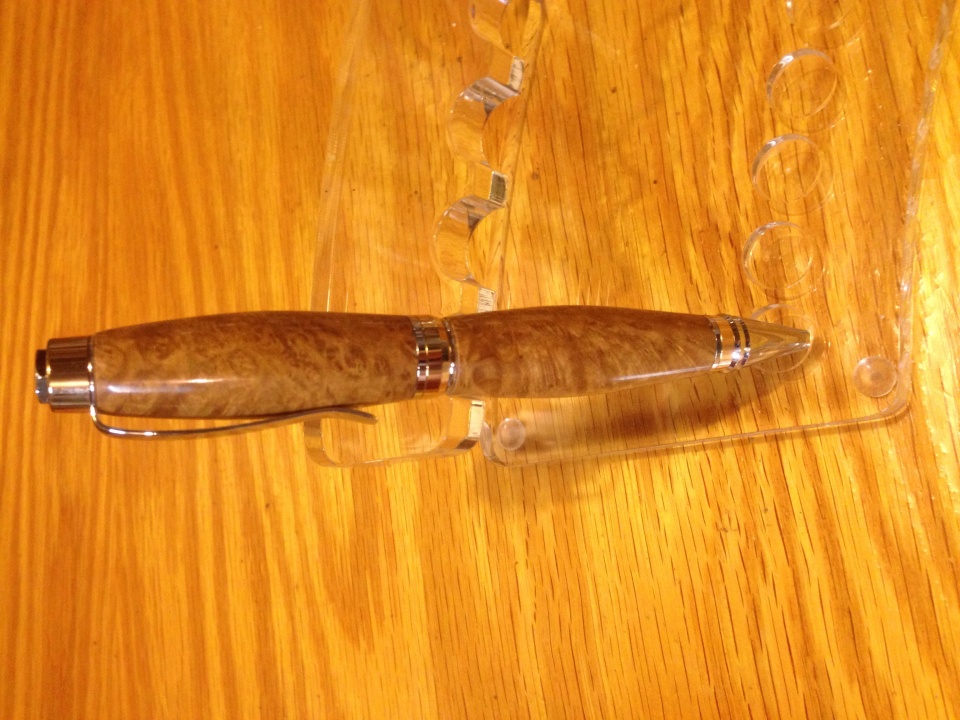

The finished pen. I was able to fix the chip out near the nib. Turned out pretty well I think. Thanks for all the help!
