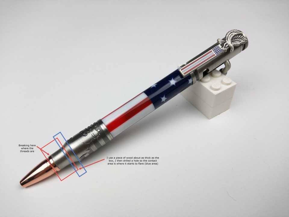

I assume the part you are breaking are the threads that the bullet tip screws onto. I have broken them before also when pressing the pen together. So I have a small block of wood I have drilled different sized holes in. It allows you to put pressure on a part of the pen that won't break.
See attached picture for a better explanation.
