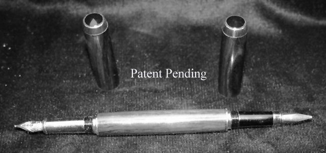

This is a prototype of a concept I have been working on for several months. Among the features are: 1) the center barrel houses the ink supply for both nibs; 2) the overall length of this model is approximately 180mm, 175mm with either cap removed; 3) numerous weight saving measures such as no centerbands, only partial brass tubes used in each of the three barrels and elimination of the clip (a clip is really useless for a 7" pen); and 4) different sizes or styles of nibs can be accomodated on either nib.
Sample uses could be:
- to provide a broader nib for cartooning with a finer nib for text
- to provide a fine nib for the body of notes with a broad signature nib.
Thank you for looking. Please feel free to comment and or critique.

Nice work. I like the creativity. I have something similar in the works with a Baron as the base kit. It is drilled and tubed but I don't think I will get to it for a while. Have you thought about wood finials or closed end caps for more weight savings? I know the weight of those finials will really be accentuated by the length of that pen.
Two questions Lou.
1. What does your bandless transition look like with the cap on?
2. What is that second FP nib? Is that a CSUSA replacement nib? I can't tell from the pic.

Thanks, Coach! Anthony, somehow I figured you'd be the first to try this, but the patent <b>really is</b> pending. [8D]

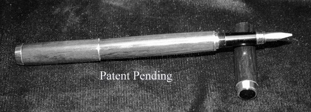

Shane--here's a pic with one of the caps on. The cap ends have the threading recessed, are bevelled and superglued for durability. Only the trim ring on the center barrel is visible.
<br />
I definitely will make a closed end version, but not really for the weight savings. The pen, with only one cap on, weighs less than a standard Baron or Jr. Gent. The balance is virtually identical to either of those two kits.
The components used are from Jr Gentleman and Baron kits plus a calligraphy nib from CSUSA.
Thanks for the comments.

Originally posted by WoodChucker
<br />Lou, interesting pen! Why is the photo in B&W and not color?
Can't slip anything past you, can I R.T.? [:D] It's in B&W for two reasons. First, the USPTO will only let you submit B&W photos and second, because it lessens the likelihood that the viewer will be seduced by the wood! [8D]

Seems Parker made a double FP, but probably not with the innovations you have developed, Lou.
From http://www.pentrace.com/article112201_133.html
"The only other combo made by Parker Pen was introduced around 1907, and as described in "Shop Talk" is called "A New Thing". The name Combo did not exist then, so it was cleverly called a Bookeeper's Special #100 model and sold for $6.00
Described as "Here is something designed especially for bookeepers. It is a double fountain pen, one end for black ink and the other for red. The ink reservoir for the red ink is mottled red, which indicates at a glance the color of the ink in that barrel. The other end of the fountain is black, which also indicates the color of the ink therein. Every bookeeper who has seen and tried this is simply delighted with it. The fountain can be disjointed, if desired, thus making two complete fountains, in which event they can be carried in the pocket in the ordinary way."

Thanks for that copy, Ken. I don't know whether my design has sufficient functional difference to be awarded a patent or not. I guess time and the USPTO will tell. [8D]

Lou, are you doing the patent yourself, or did you go through a patent lawyer? I assume it's a utility patent and not a design patent? The pen above should have been found in the prior art, and if so the claims should have been worded to say how yours improves upon that one and others that may be out there.

I forgot to ask. How did you recess the thread fittings on the cap? How did you get rid of the trim ring? If you saw my stubby Baron you'll see I used something similar and want to know how you did it before I ruin a few kits.

Bruce--I did the research myself. I reviewed over 1200 utility patents in painstaking detail. Unless I missed one, maybe Parker's patent was a design patent. Mine is utility.

Woodscavenger--the trim rings were not used at all. The recess was measured with calipers and pressed in carefully.
