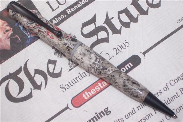

Several pieces of information have entered my e-mail that will help the aspiring paper pen makers.
1) Using CA does not work well, the paper acts as an accelerant and bubbles are the result.
2) Construction paper may well have water-soluble coloring.
So, Use watered down white glue if you are using "printed" (oil-based) products. Don't do this if the colors are water-soluble.
Test first.
To add credibility, I received the following picture and the permission, in fact enthusiastic encouragement, to post it.
<br />
Courtesy of Eagle.
Clarification: (straight from the source):
Eagle writes me:
"I didn't say anything about bubbles.
I just said the CA will set before the paper absorbs it.
I have used CA with construction paper,
In a solid glue up beware of blow outs, go slow,sharp tools,add CA as you go.
Treat like rotten wood."
