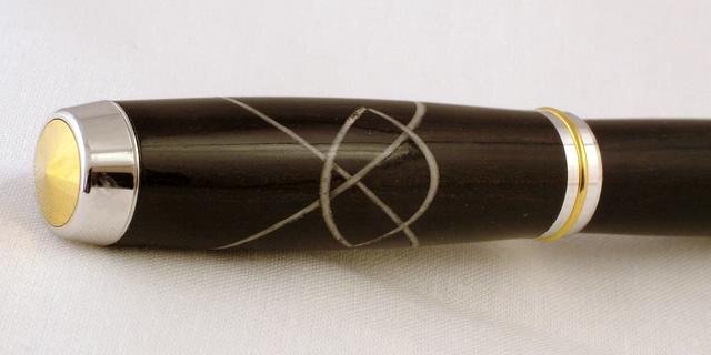

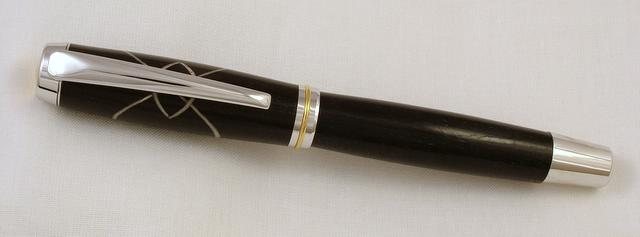

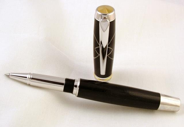

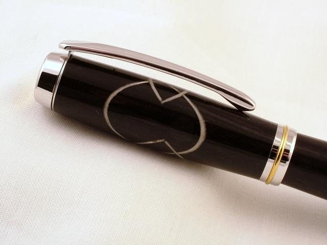

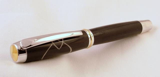

I thought about doing another inlay on a darker wood with something pretty white so I decided to try paper. It's free and readily available so I inlaid this pen with the backing from a package of drill bits- it's a thick, heavier than cardstock type paper and had print on it and everything. I inlaid all the pieces using the bandsaw and some glue and then I saturated the paper with thin glue. It was a fun experiment but I think I'll use my pen to write on paper instead of using paper in my pens. The lines aren't as crisp as I'd hoped and there are some dark spots that were there before I started sanding. This pen is the Platinum Jr. Gent Version 1 with African Blackwood and American Paper. It was sanded to 3600, finished with spray lacquer and then buffed with Pen Polish. The pics don't show it real well but there's quite a glassy shine on this one. Comments/Criticisms/Sarcasm/Tips welcome.

Neat idea, and of course beautiful work, even if it didn't work as well as expected. I bet it would work just fine with some of that plastic stuff that's used for thin 3-ring binders. Poker chips will also work, used in fishing rod grips quite often.
alamocdc
Apr 26, 2005
7,970
San Antonio, Texas, USA.
Interesting concept, Nils. White or cream pick guard (the single layer stuff) would have given you the clean lines you were looking for. Great job on the pen BTW.

Nils; I agree with most of the above comments. However, I looked at the images prior to reading your explaination. My first thought was he's figured out how to obtain a muted design rather than the ones that screem "I'm different" The only image that I had to a second look at was the bottom one showing the dark spots. Think like Tom Edison and figure out how to make it work and don't worry about what didn't.

Great idea. Although it's not as clean as you'd like, looking at the closeup pics it reminds me of something that could be used in a moonscape or constellation. I can see really crisp white stars using your paper effect trailing behind for a shooting star look.
