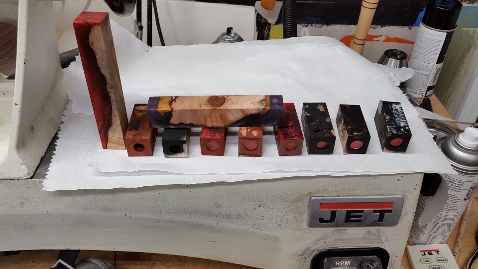

As it pertains to turning pens, what is the difference between painting and reverse painting?
I am prepping a bunch of pens for a client and she likes to see the steps.

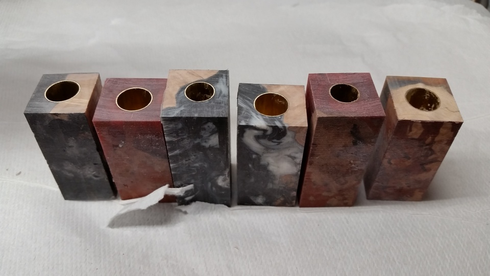

The inside of the two blanks/barrels from the left have been painted. Yes, it is the inside of the turning stock that is reverse painted. I do not know the etymology of why it is called "reverse painting" - perhaps because the interior is being painted versus the exterior.
I like reverse painting because is hides not only the tubes (the brass, white, nickel things that comes with a kit), but it also hides the glues lines. Some know how to glue the tubes insides the barrels without the glues lines showing; I do not (nor what to learn).
I like using primer in all colors depending on the blank or effect.
I am a CPA, not an engineer, so I cannot comment on how these processes affect the structural integrity of the finished product. I would think the fewer the "materials" in between two glued services, the better - but I have know anecdotal, nor scientific proof.
I paint both the exterior of the tubes and the interior of the barrels and use epoxy. To date, and after close to 1,000 pens, I, nor any of my customers have reported any failures...that doesn't mean there are none or that the joints/contacts points are not weakening.
The barrels to the right have been reversed painted and the tubes have been glued inside. The other photo shows the barrels trimmed (made flush with the tubes), but still need to be cleaned out.
I hope this helps, and I hope I did not discount anyone's process or experience. I can only report my own.
Enjoy!
BTW, thank you for serving our country and protecting my freedom.

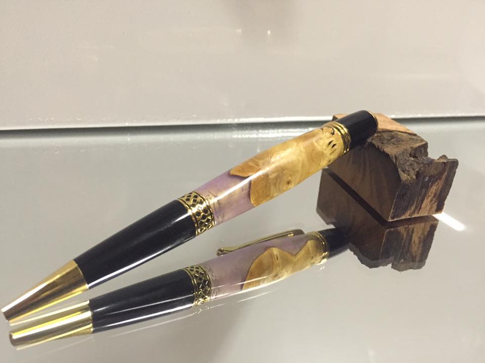

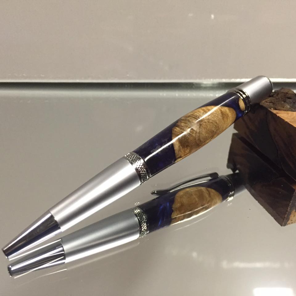

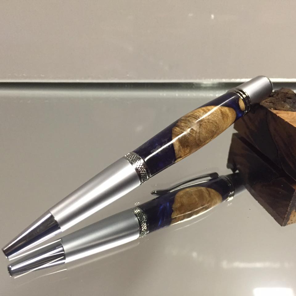

Attached is a good example of the contrast painting the back of a tube can make! Both of these pens are made from the exact same blank. The darker one I painted the back of the tube black and the lighter one was left unpainted. You can see the brass tube through the lighter one and see how much more depth the painted blank has in the colors. I dont think painting just the tube will give you this depth of the blank either. I think it has to come from the backpainting of the blank.
