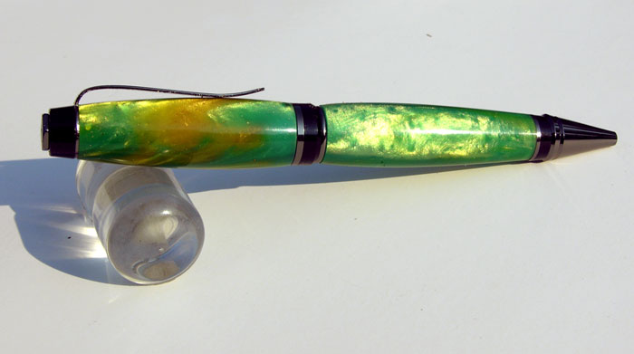

I found out that I need to match the color better or use a lighter color! Here's my first "success" at an acrylic pen--I reverse painted it black. Should have gone with green or silver, as the blank now looks blue, though it was green when I started!
Also found out that if you paint the tube, you can still see the glue between it and the blank. From now on I'll reverse paint all my acrylics!
