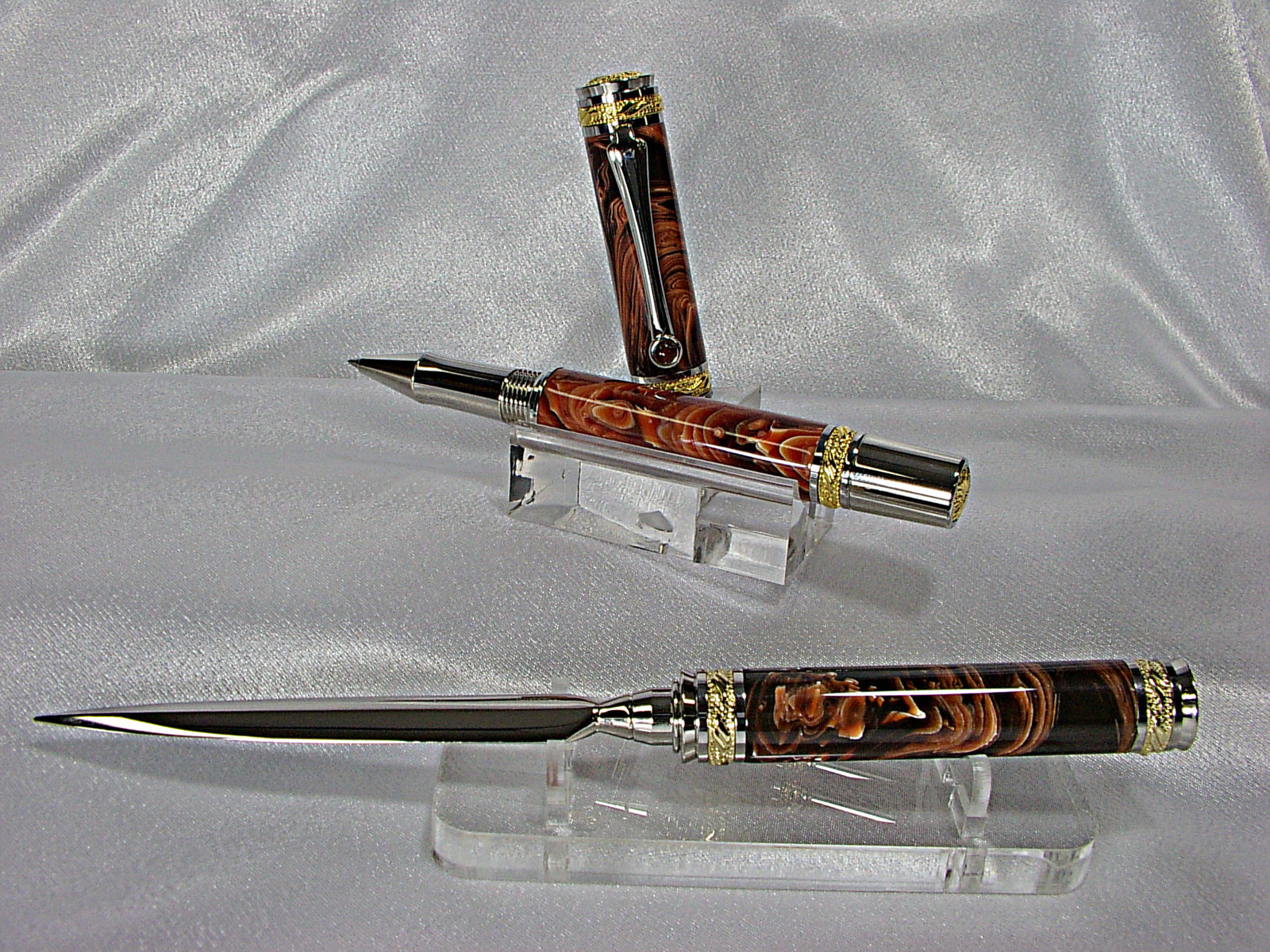

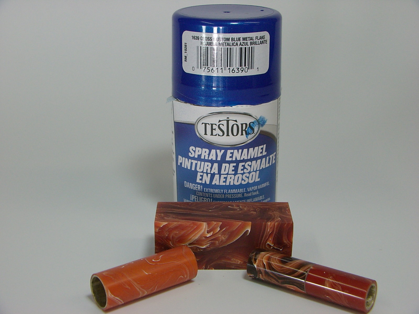

Not sure about the statement that white makes the color always pop. This comes down to choice. Changing colors can affect the look of a blank and some blanks need color. Here is an example I have shown before. The pen and letter opener were done with Mexican Agate truestone and the blanks were reverse painted with a metallic blue. I have shown the look of the same material with white on the left and a reddish brown on the lower right. The upper right is the blue and to me that is what made the color pop. The white washed out the blank too much.
