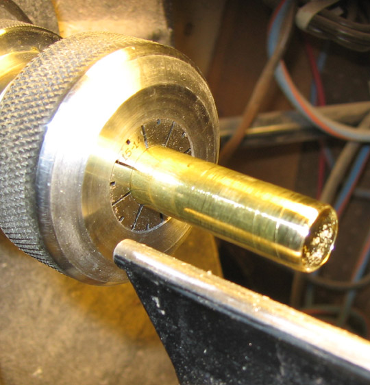

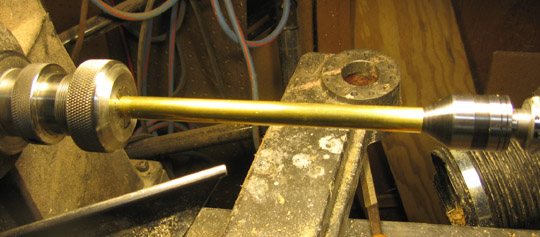

parting off tubing
Collet Chuck to hold the tube and a parting tool to separate it. Deburr the end with the edge of the parting tool.
(tried to attach photos but they did not stick).
KenV
Oct 28, 2005
4,720
Juneau, Alaska.
photos of parting off tubing on the lathe
2nd try at pictures
