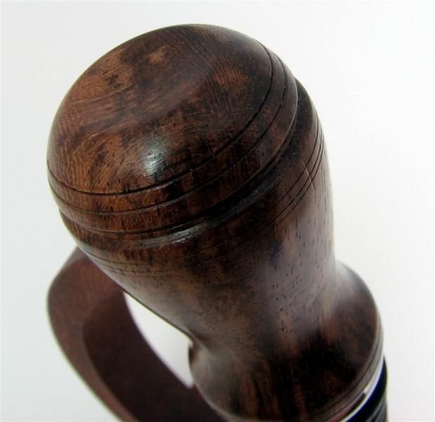

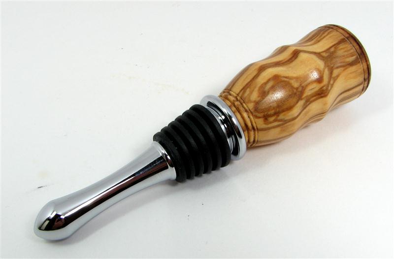

Well, actually it's 2 and 3. #1 just wasn't quite presentable as an end result :redface:
The dark one is Mora, the light one is Tamarid

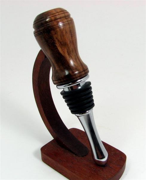

Is the wood fuuly seated on the stopper in the second pic? Looks like there might be a slight gap. Otherwise very nice.
Carl Fisher
Jun 7, 2011
2,761
Cape Coral, FL
Nope. I actually need to back it off and flush the tenon up a bit so it seats all the way. Was hoping nobody would catch that :)
After the first one, I swore off the stopper mandrel and decided that turning the old way with a good tenon and 4-jaw chuck was a much better option.
May 1, 2012
217
Destin, FL
Carl, it looks like you source your stainless stoppers from the same place as me. You will most always have a problem getting them flush with the bottom of the stopper as I don't think they do a lot of machining to ensure a flat top. To solve this, I have started countersinking the bottom into the wood/plastic in a chuck prior to turning on the mandrel. It doesn't take much longer and the result is well worth the effort. This will be almost a necessity if you have bought any of their mini cone stopper as the top actually isn't flat at all but domed.
