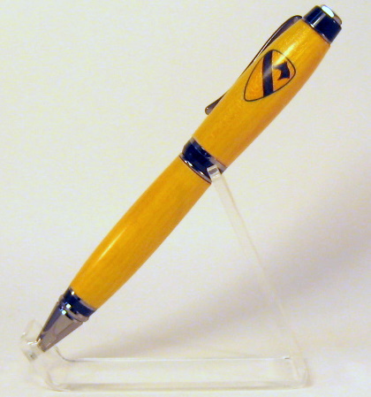

I'm watching quals too! :biggrin: Sharon, I made this pen for my barber who is a 1st Cavalry veteran. The pen did turn brown within a couple of months after I gave it to him. Not only did it turn brown but, the CA came loose in places and the pen just plain looked UGLY:redface: I couldn't believe it was the same pen. Just wanted you to know what happened to MY pen. Doesn't mean it will happen to you. Go ahead and, try it out.
