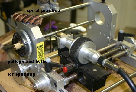

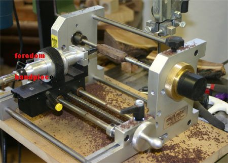

Many of you asked about the baron with the facets and how it was made. Here are some pictures of the ornamental mill I used. It is called 'The MillLathe' and was produced to mill small wooden objects but is now out of production. There are 15 kits that allow tapering, face plate work, center to center turning, template use, and other thins I'm not sure what they are. There is even a mill kit(rotary table) which add the "Y" axis movement. Wish I had that part. Here are some pictures.

WOW!!! You got it assembled nearly right [:D]
Beautiful lockpin from index wheel to pulley, it immediately attracted my eye [;)] You should flip that upper pulley, though. Look on page 13 of the manual. This gets the large pulley closer to the index wheel, right up against it, and allows for better coupling. Align all the other pulleys starting from that one, working down. Your spiral cuts will improve from less play and chatter

The lockpin on the upper pulley and indexing wheel was a gift from Rich. Thanks Rich! Itis much better than the one that come with the MillLathe. I had the upper pulley flipped around, took it off and hurridly put it back on for the picture and put it on backwards. Thanks for telling me, I probably would not have noticed. Spirals are next.

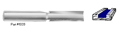

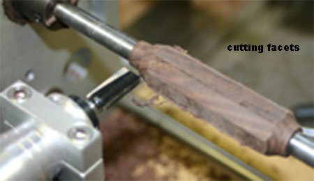

What type of bit are you using to cut the facets?

the mill's mandrel will hold both blanks for a pen but in the picture I was making a letter opener handle. I'm having fun with this little toy. Wish I had gotten it out and learned to use it sooner.

The bits I use for the facets are a 1/4 and 3/8 straight bit. I'm experimenting with some different bits(with pointy things on the end) to do the spirals.
Here is a pic of the bit I use to do the facets. You could bring the Legacy to Wichita Falls oct.1 and demo it for us in the penturning sessions of the SWAT symposium (http://texasturnortwo.com)[:D]

<br />What type of bit are you using to cut the facets?
I think you're best of with the smallest bit that cuts the facets. I you use a larger bit (like 1/2") you'll get more chatter.
