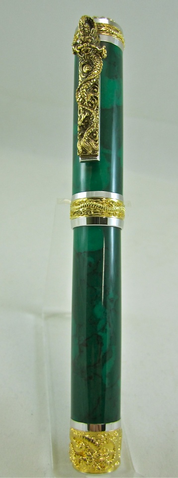

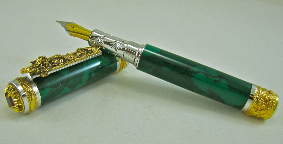

The biggest problem with making pens is that when I see a kit that I have not done before it is like an itch that has to be scratched. While surfing the usual pen guys for anything that I didn't know I needed, I came across this kit on Exotics site. Being that I had not seen the kit before the safe move was to put it on a Jade Tru Stone, not much imagination but it was the safe choice. I really like this kit, It is flashy, but it will fit in with the other hi end stuff that I have on the hi end display. The Jade Tru Stone turned well (this was the first time I used this blank) and polished up beautifully, not much else to say, pretty much straight up penning.

I have made this kit, and matched it up with some vintage Bakelite (posted a few weeks ago), which worked well. You choice of jade TS, admittedly a "safe" choice, goes very well. My concern with the one I made that there was not enough visual definition in the clip, what with all that gold and so much detail. You addressed that issue with some type of antiquing, which I think improves the overall presentation. Well done.
Would you mind sharing what method/medium you employed?

Would you mind sharing what method/medium you employed?[/QUOTE]
to define the detail on the clip I used a candle to apply the soot to the clip,I wiped off enough to bring out the detail and finished with acrylic spray lacquer
to define the detail on the clip I used a candle to apply the soot to the clip,I wiped off enough to bring out the detail and finished with acrylic spray lacquer[/QUOTE]
Wow! That is a cool solution...don't like the component set the way it is, just burn it up a little!:eek:
I like it, and will try to experiment with that technique. Thanks!
