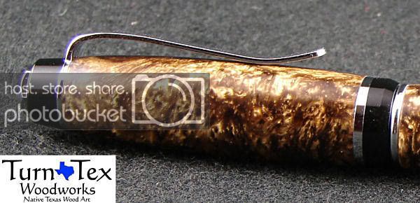

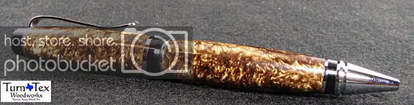

I have been playing around with casting resins with my cactus pens and decided to try a straight resin blank. Here is the results of something I came up with. In person it looks AWESOME but the pics don't do it much justice. It is gold with a LOT of depth and glimmer. What do you think? I have never bought and turned any plastic blanks. Is there anything available out there that looks like this? If not, I might be able to have my arm twisted to show how it was made! EXTREMELY easy!
Anyway, here is the pen...
And here is a close up

The resin looks fantastic! Am I right to assume that you will be bringing one to SWAT to show? I would love to see this in person.
You know what....I would also recommend that you supply each teacher of the pen turning classes with a blank![:D]

Curtis, if the pictures really "don't do it much justice," then I sure hope you are planning on making a LOT of it, and selling it here, becuase the pictures are drop-dead gorgeous and I think there will be lots of us who would love to try it out. That really looks great!

I've looked at this several times trying to come up with what it might be. First I think the resin is epoxy since that what Curtis used on the cactus blanks. The color looks like Testor's gold pigment. That's a pretty wild guess, but it's the only thing I have ever seen that looks like that.

It is definately not plexiglass or ANY kind of epoxy. The resin is Allumilite Clear, which is a urethane casting resin. It sets in 8 minutes or so.
West Systems epoxy is great as an expoxy but is not that great for turning. It is much more brittle once cured than Alumilite. As for hardness, both are about the same. West has a Shore D hardness of 82 while Alumilite is 80. Epoxies are not intended to be used in thick castings like Alumilite or PR. They are mainly made for laying up and thin applications. They easily overheat while curing.
I experimented with a buch of different epoxies, including West System with 105 as well as System Three with all of their different hardeners when I was perfecting the cactus pen process. Epoxies were ok if pressure cast but tended to shatter while turning unless you were VERY careful.
As for the colorant, I beleive I will keep that confidential for the time being. I may want to make some of them to sell and don't want someone beating me to the punch just yet! For anyone who wants to try it for their own use, send me a PM and I will share with you. I just don't want to post it on a public forum.
