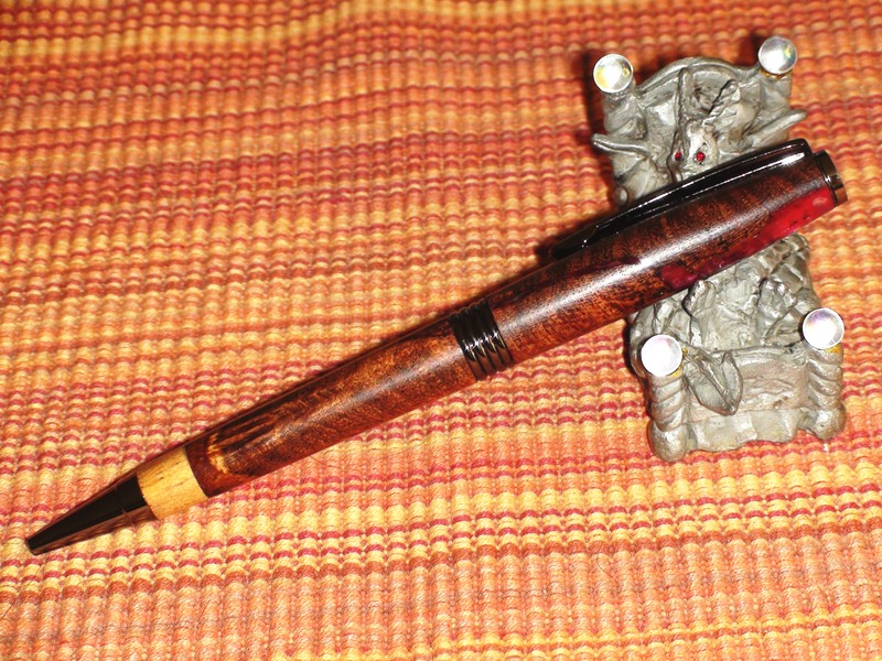

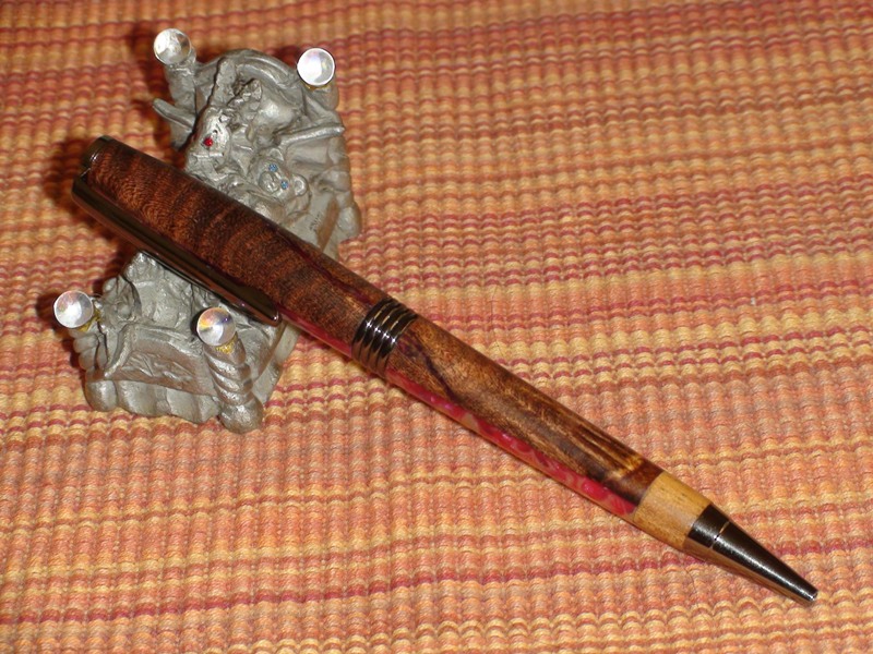

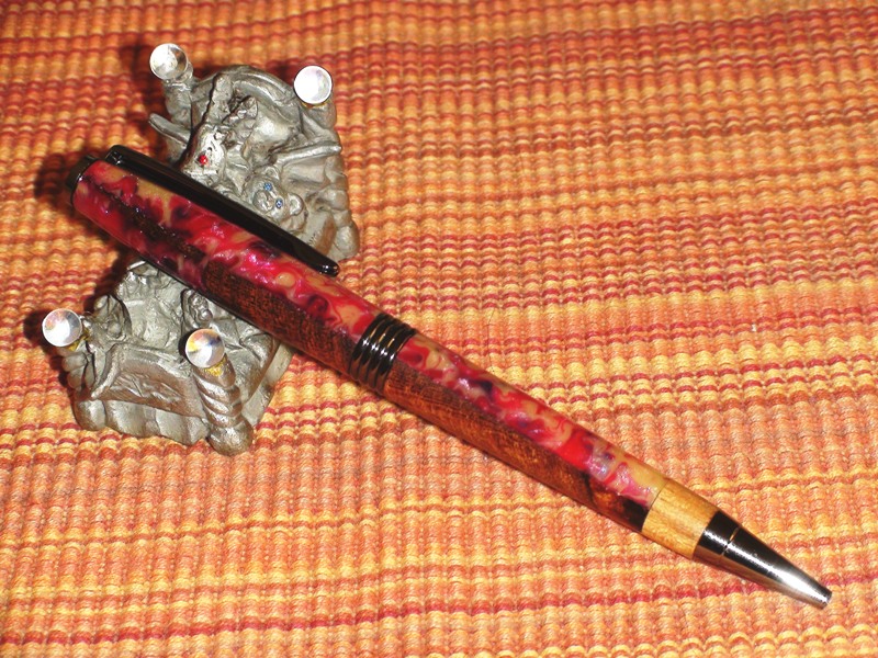

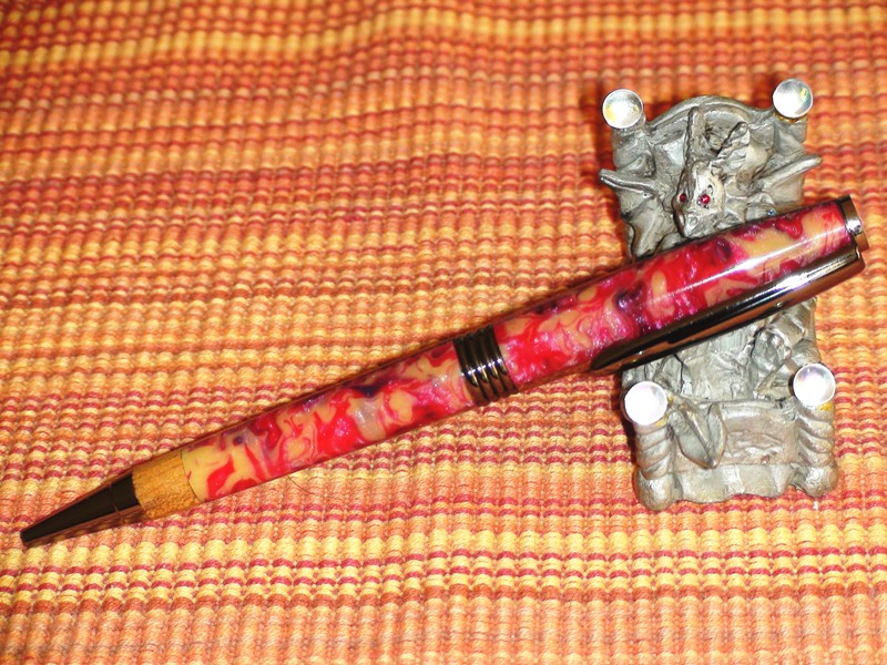

This is a pen that I was trying something new on. I got the blank from maxman400 again and as I was turning it I tried to put some finger groovces at the tip of the blank. As I was cutting the thrid groov it broke so I just cleaned the rest if it off the tube and glued a piece of maple on the end and started over. The kit is a Trimline in black Ti from PSI. It was sanded through 600, 7 coats of CA/BLO, sanded to 2000 and polished with Maquires.
All comments and critiques are welcome.

Nice Save, Looks good for your 2nd Pen. The back ground kinda conflicts with the colors of your pen, you might try a neutral color like a gray or tan. I told you this was addictive...LOL
