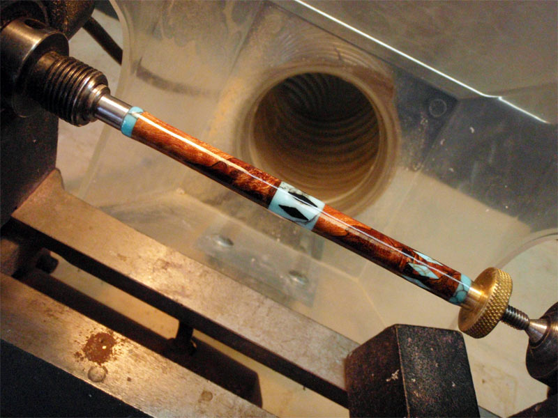

Final coat of CA is drying before sanding and polishing.

How do you cut such small inlays?
I use a CNC machine made by Unique Products called the CueMonster.
The end mill is .02" in diameter and cost $15 each.
It kills me to break a bit and being so small that is not hard to do.
Drop it on the floor or bump it with anything and it's $15 please.
Rather expensive at $8000+ but less than a good laser machine.
You must also learn to draw and program the inlays using software on a PC.
I will post some photos of it in action later.
