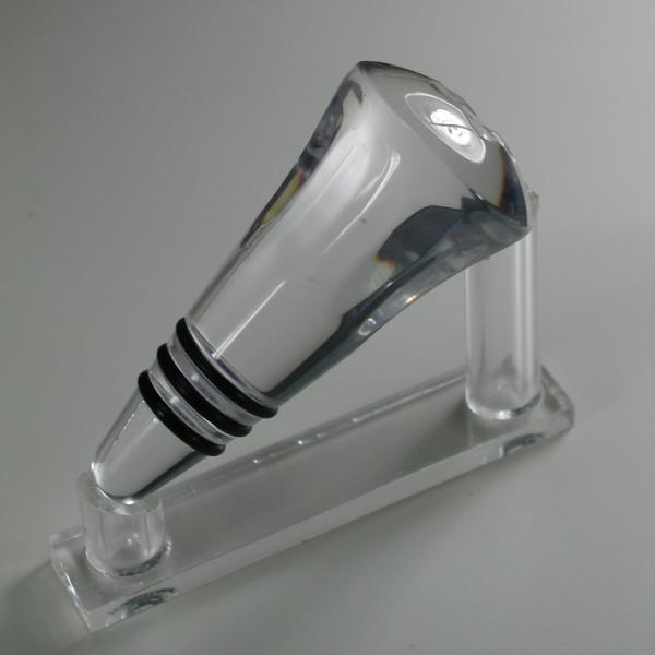

Sorry, I am on a stopper kick. This one is a one piece [strikeout] acrylic [/strikeout] PR with O-rings from Lowes.

Chuck great idea. You may have opened a whole new theme. You say you are new to the casting thing but it came out flawless. What did you use as a mold??? Did you use a pot??? Maybe you can give us a little highlights of your method to cast this piece??? Thanks.

The mold I use is a recycled plastic bottle from an auto parts store. I found one I liked for shape and purchased the bottle. Gave the contents, engine treatment, to the sales person and took the empty bottle home. I do not use a pot and mix the PR in a cup and pour it into the mold. Nothing special.

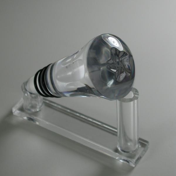

Here is another one with a little detail on the stopper end.
