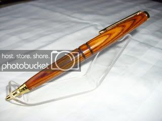

Thought I'd have a go at making a slimline with a single piece body.

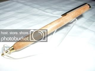

Wasn't that impressed with my first attempt,as I thought it was missing something:confused::confused:.
so thought I'd have a go with a nice cocobolo blank and this is how it came out.
Comments and critisisms please as I would like to improve these:rolleyes:.

Looks pretty good..yet I see what you mean..it's like a bit of boredom going on too. The burn marks help a lot. Maybe it would look good if you put the burn marks down by the nib instead. I think the main problem you have though, is the wood you used in both cases is rather blah. When you spice it up to a nice burl, or segmented blank, then it will surely look better as one long clean barrel.

I have fun making these Jeff is correct you need a blank that has character to really show them off. I have made several and sold them within 2 days.
