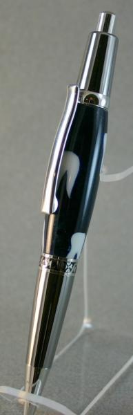

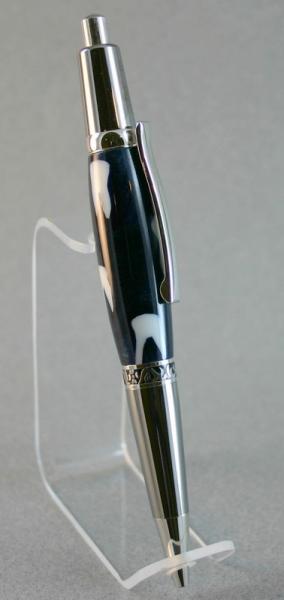

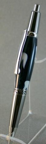

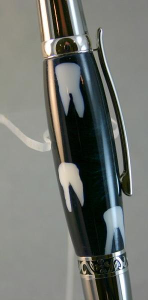

Here's a pen I made for my dentist.
I cast the blank with blue Alumilite and the teeth are white Corian.
All comments and suggestions are welcome.
Thanks for looking.

My wife won't let me buy a laser so I cut them out 1/8 thick Corian with my scrollsaw.
I then sanded the backs to match the curve of the tube and epoxied them to the tube.
I then casted the tube in Alumilite.
Mike
