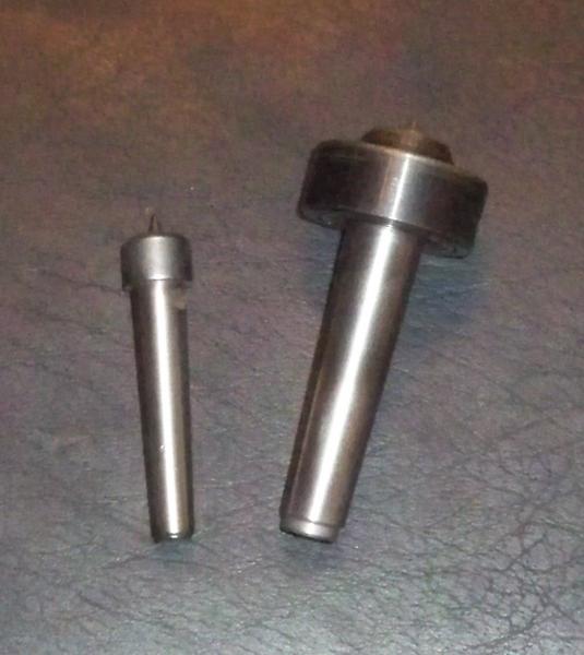

Here is the Cup Center from my friends lathe (MT unknown by me) next to my #2MT Live Cup Center. Can someone tell if the smaller is a #1MT or not. If you can positively id. it I would appreciate it.

The head and tail stock should both be MT1 and the thread on the head stock 3/4 X 16. Been there done this on a similar lathe. Finding some parts short of making them myself was impossible.

That lathe appears to be in beautiful shape for it's age. I had one just like it. It was a great lathe for it's day. Specs are 3/4-16 headstock thread. Number one (1) Morse Taper in both Headstock and tailstock - not zero. There was a real small Craftsman metal lathe that had no.0 mt but this wood lathe was no 1mt. It's built very well. Sears at the time sold two qualities of tools:Craftsman which was the "best" line and another brand which was called "Dunlap" and which was in the "good" category. (in those days many Sears items came in three qualities: Good, Better, Best and tools were only two qualities of which Craftsman was the best. This Craftsman lathe was really built well - unlike the dreck that Sears sells now. At the time Sears sold bed extensions for this lathe to enable you to turn longer spindles. I think they added either 18" or 24" each to the bed length. I had two of them so I could turn real long spindles. I loved that lathe. Sadly I became disabled and couldn't get down the basement to use it so it got sold along with a drill press and a band saw. Because of it's age, I'd be concerned with the headstock bearings, condition of the pulleys, and condition of the headstock spindle threads and most important the condition of the Morse tapers in both headstock and in the tailstock. A minor thing is the indexing pin. It could get sheared off easily if you had a powerful motor (I had a 3/4 horse) and started the lathe with the index pin engaged. That's a small thing. You can still use the lathe without the indexing feature.. If all that's okay, it should be fine for pen turning. Rockwell, Woodcraft and Penn State all make Mandrels, mandrel savers, drill chucks etc in Morse 1 taper. If I still had mine, and could get to where I could use it, I'd certainly use it for that purpose.
