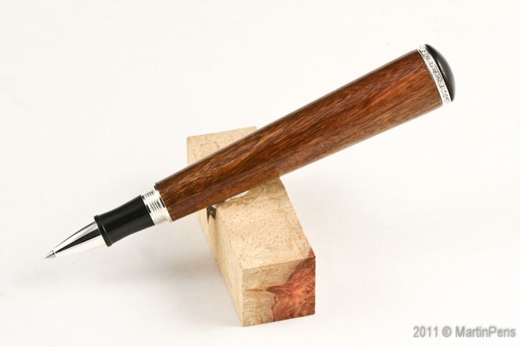

Got a piece of Ohia (had never heard of it) as an extra along with a deburring tool I ordered from Hunter-27 (Landon). It was the only piece I could find big enough for what I wanted to do and worked out great! Beautiful wood. Read about it here.
(the blank the pen is sitting on is not Ohia :biggrin: )
The diamond/silver band is a ring I got from Kohl's (on sale $7) O.K. they're not diamonds! : ) but they're sparkly!
It is a closed end pen with a blackwood finial cap.
I haven't designed the cap yet. I have no idea what is going to work for the cap. Hoping I will work it out in my sleep! :yawn: The kit is a sterling silver Churchill.
Enjoy!
Martin

Andrew Arndts said:
Is that a toe ring or you just made so it will seat down perfectly. Very nice.
It's just a regular ring, but that's an even better idea - a toe ring! I was wishing the ring was smaller. Hoping to get the design to work - similar to the Pinache but classier. A toe ring would allow for different applications.

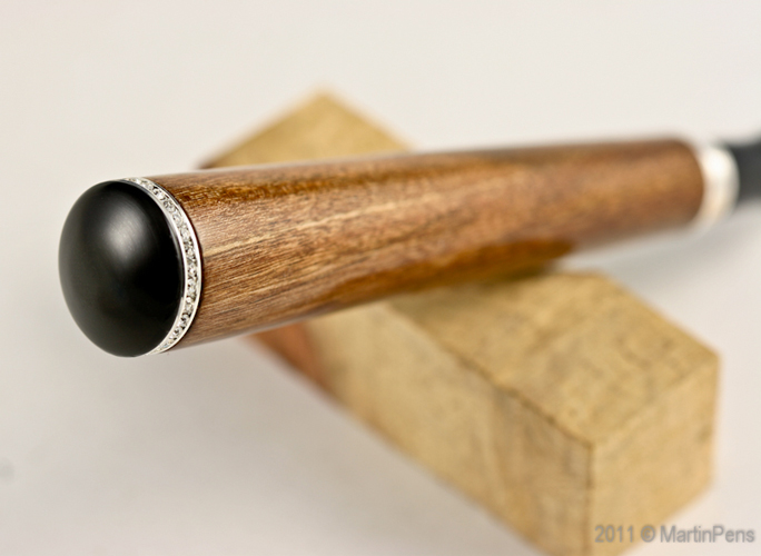

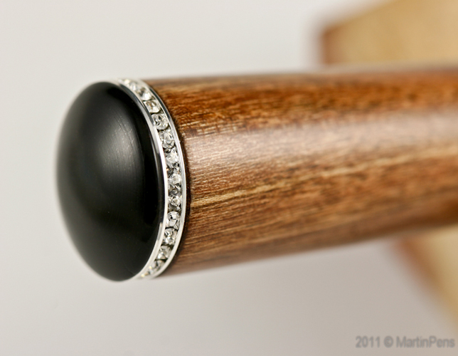

I turned the blank at a gradual increase ending in a diameter larger than the ring. With the calipers, I knew where the ring would go flush with the blank and I gradually cut a notch until the ring slid on snuggly. I then moved the notch closer to the nib slightly until the diameter matched the pen diameter (actually a little wider since I had sanding yet to do). I then turned an inset hole on the end to receive the cap finial.
I took the closed-end mandrel off the lathe with the pen on it and mounted the blackwood piece. I turned the blackwood piece down until it fit in the inset hole, trying the fit after very small cuts. Once it fit, I worked on the shape until I liked it. I parted the piece and glued the ring and the cap finial in place and then remounted the closed-end mandrel and finished the end of the finial. Now if I can just remember all of this. : )
Martin
