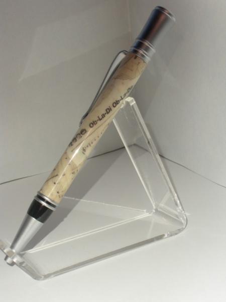

I made this pen for my sister for her birthday. She is a Beatles fan obviously. I got the idea from an art piece she made for our mother. I made it like others have made the postage stamp pens. I printed out the sheet music to Ob-La-Di Ob-La-Da and aged it with tea. Then I just randomly tore it into pieces and glued it to the pen. Then a coat of Modge Podge. Then finished with CA. Thanks for looking.

What's Hodge Podge?
The modge podge is a sealer/glue. I had never used it before this. I only used it because I watched a video from Penn State Industries on making a postage stamp pen. They used it before the CA finish. I didn't know what the CA would do to the paper and the modge podge was only like $3 so I used it just in case.
