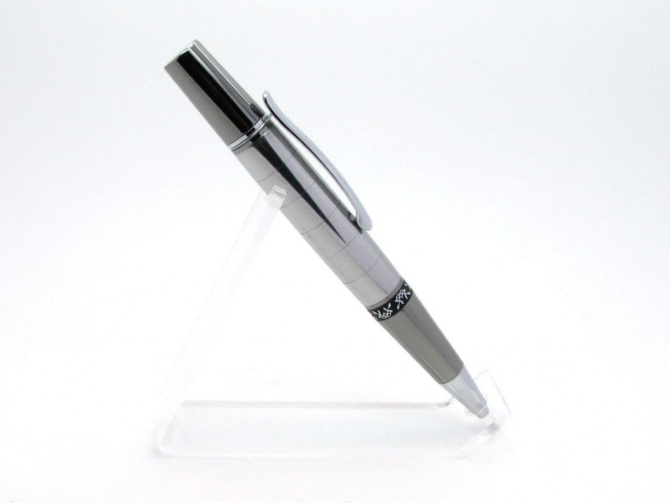

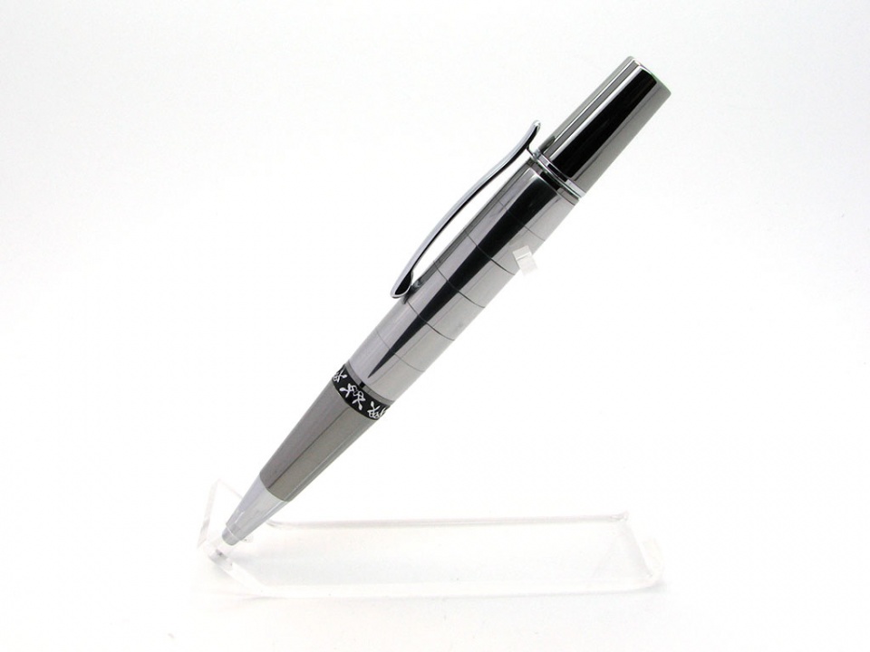

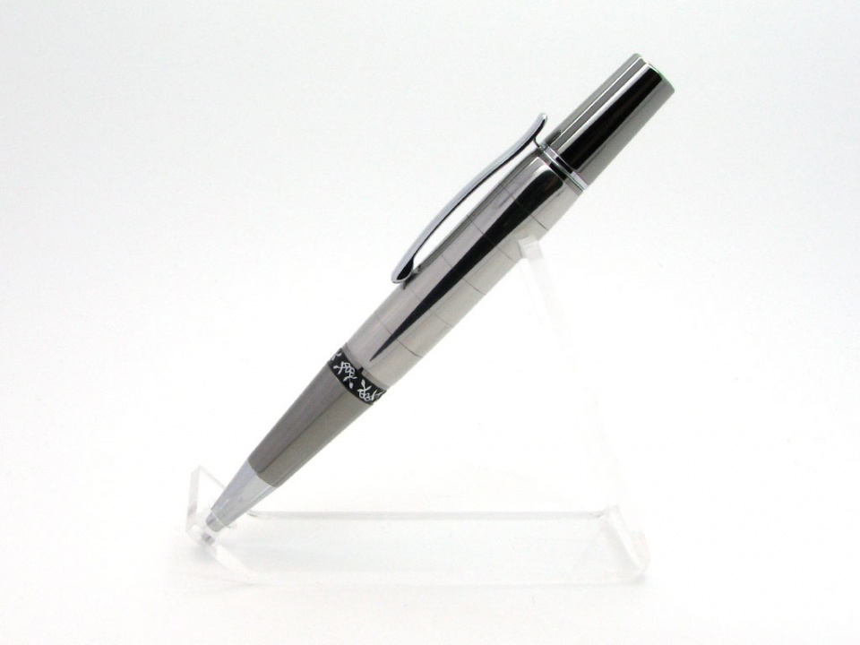

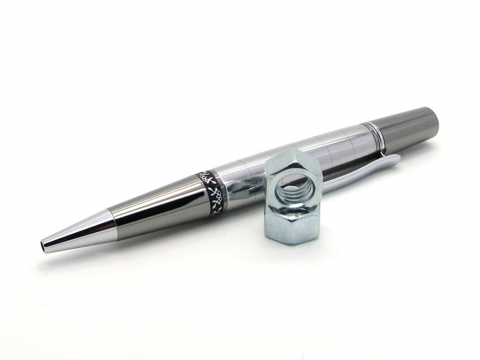

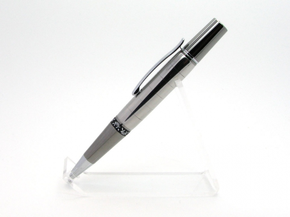

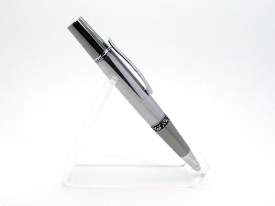

This one is made from 3/8 hex nuts that were glued together on the tube and then turned and polished on my wood lathe.
I did it as an experiment and I'm really pleased with the results.
I don't know if rust will be an issue though. :tongue:

They are not stainless steel, they are the standard zinc plated nuts that you can find everywhere. I'm not sure what kind of metal is inside but it's prone to rusting. I left the water container I used to wet sand sit overnight and the color of the water changed from black to dark red. I got some stainless steel nuts but I didn't have time to check if I can turn them or not.
I glued the nuts with epoxy glue. The brass tube didn't fit inside the nuts so I needed to remove the threads using a drill with titanium coated drill bits. I used HSS tools to turn the pen and I'd say that it was slightly softer than black trustone.

I let it on the bare metal. I'm afraid that if I apply CA on it some rust could develop under it, and it would also lose the cold metal feel.
I think I'll keep it for myself so I can see how it evolves, if it develops some kind of patina or rust.
The weight for this pen is 61g. I checked the weight of other completed pens of the same model and both acrylic and wood are 40g, and M3 is 44g. So it's about 50% heavier that a standard pen for this size. :eek:

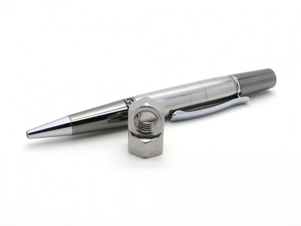

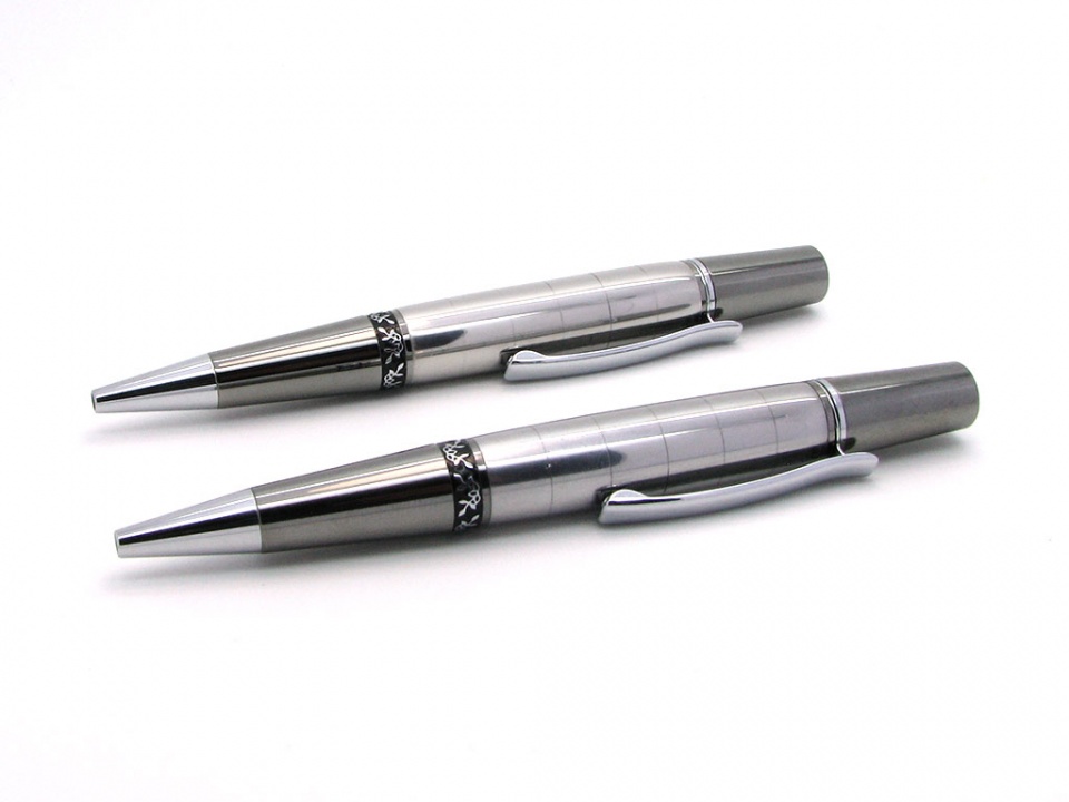

I just finished another pen but this one is with stainless steel nuts. I don't think I'll take a picture because it's almost identical to the other one. Stainless is harder than the other metal and was not fun to turn with HSS tools. I had to go slowly and resharpen often. I even broke the tip of my drill bit when removing the threads inside the nut to make room for the brass tube.
I don't plan to do that kind of pen often unless I buy metal tools :rolleyes:

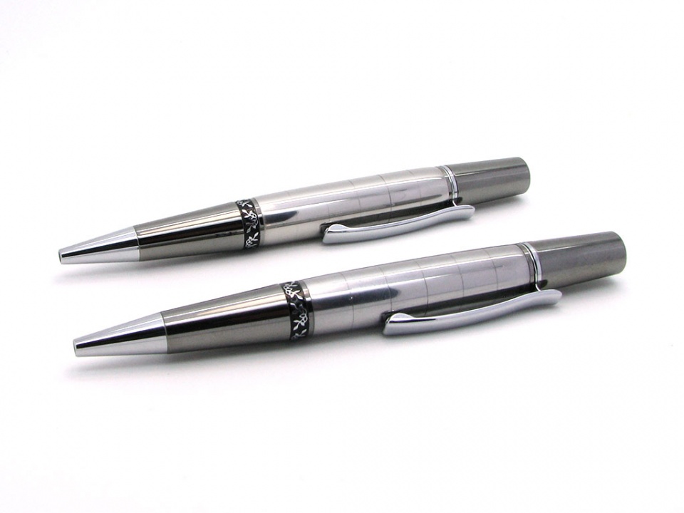

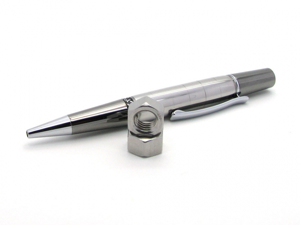

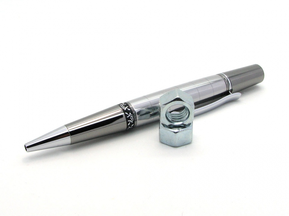

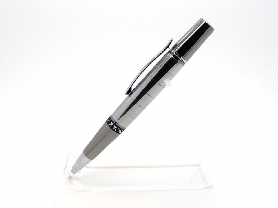

Some more pictures.
The first 2 are pictures of the pen made with stainless steel nuts.
The 3rd one is a side by side comparison (the bottom on is regular steel and the one at the top is stainless).
The last one is a picture of the hex nuts pen with the animal who inspired it! :laugh:
