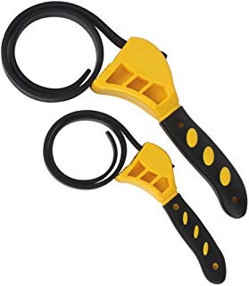

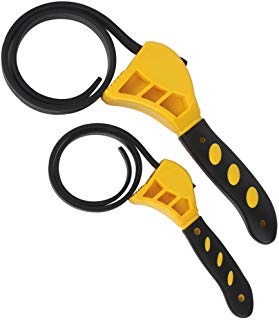

Try a belt/strap wrench. Hold the headstock wheel and turn the chuck off with the belt. Should work out fine.
