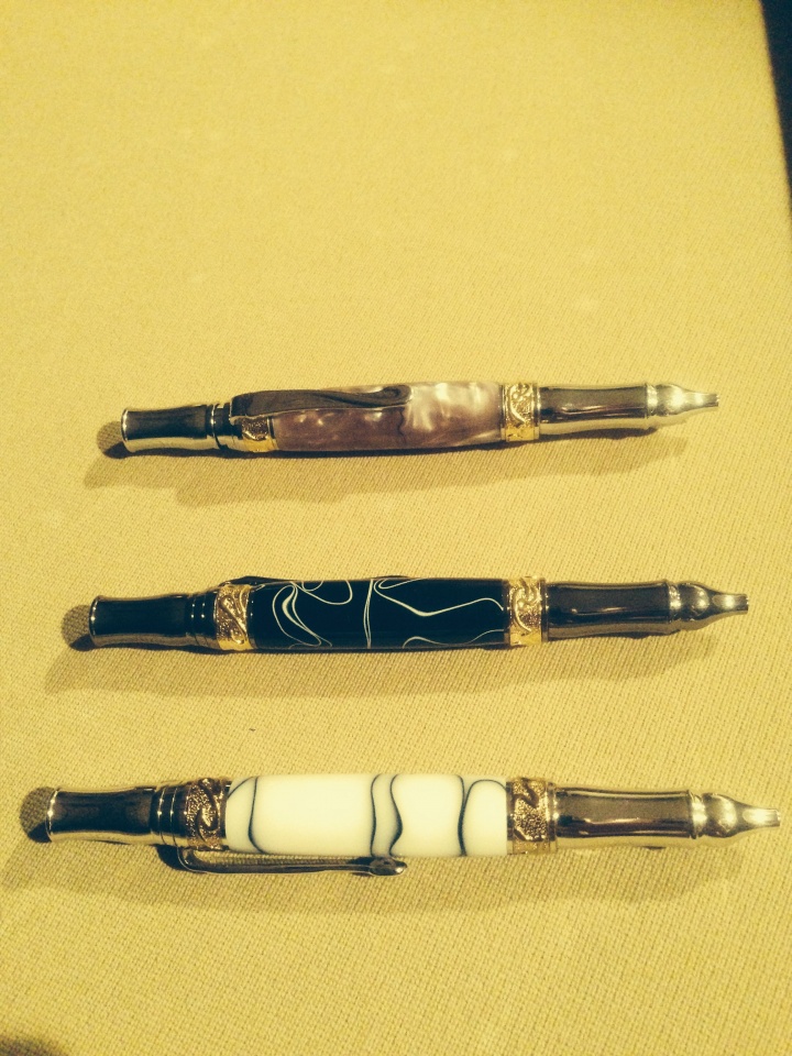

I really like the look of these pen's. So when my 1SG and CSM came asked for a nice pen for a General that is leaving from our Chain of Command I showed then this pen kit(I have 3 on hand) they loved it. So last night i turned the blank and started put the pen together. It was not retracting the refill. So i checked the spring and the transmission. The transmission is not working like it need to. so i check the other two kits i have and neither one works ether.
Now the rant this is not a good average for PSI on these kit. I have bought 5 kit and only 1 worked first time go. I really like the look of this pen, But it will be the last time i buy one again.

I had the same problem. I reduced(filed) the diameter of the black plastic portion of the refill and it works fine. I think the inside diameter of the mechanism is slightly off making the refill bind. Let PSI know about this. They are human. They will make good. The pen is absolutely a beautiful piece. Don't give up on it.

Thanks, that worked but now if he want to replace the refill it still won't work

Give him a trimmed spare refill for now. I'm calling PSI tomorrow to report the problem.
Let PSI know about this. Ask Tony (customer service tech) to send you replacements after he checks them out. Request replacement Twists and a refill or two.
