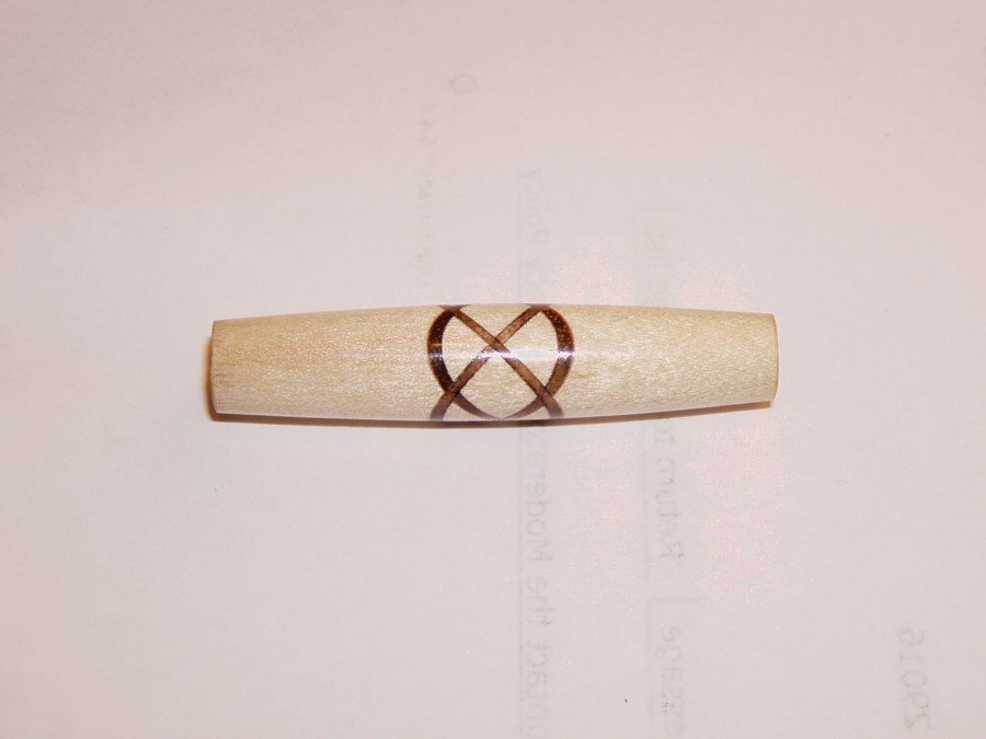

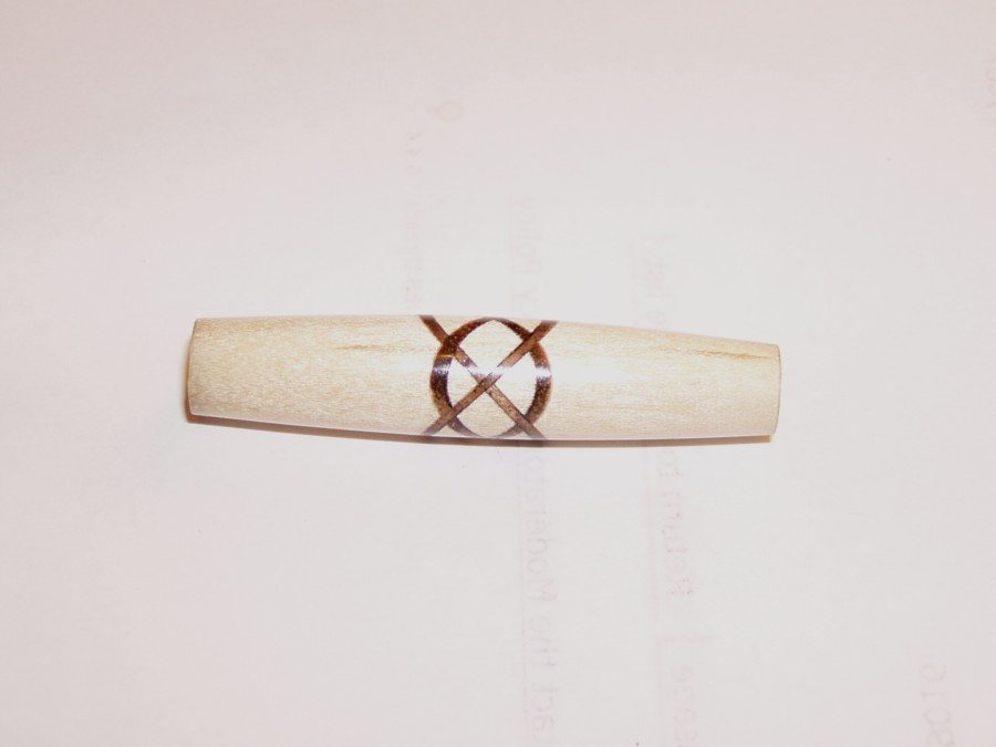

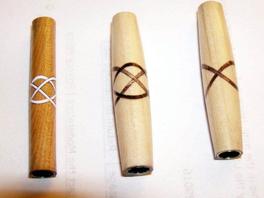

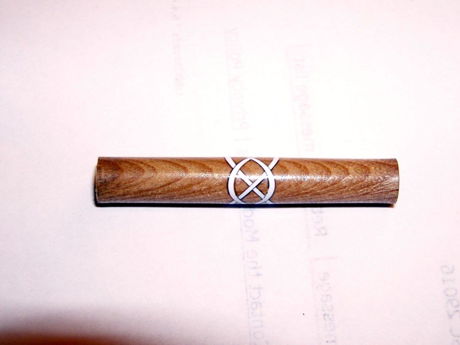

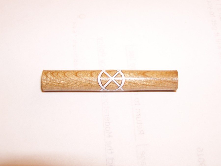

Cutting Knot is one job...It seem to work really well. However I can't seem to get my knots even. A few picture blow should help to see whats going on. One side of the knot seems to be larger then the other.
As you can see I have done 3 and I'm getting the same problem.
The first one is made from credit card....really a krogers card and the wood I'm not really sure.
pic 1 side 1
pic 2 side 2
The next one I have the same problem....blank is maple with a walnut knot. The jig that I built also cuts the thin piece of walnut at .042 is what these piece happen to be. But I have the same problem.
pic 1 side 1
pic 2 side 2
I really think my problem lies in my drilling, but not really sure.
Any suggestions would be appreciated.

That is not a bad job on the knot. I think that your drilling is not centered. Not sure how you drill, but if you have a chuck for the lathe it, IMHO, is far superior to keeping the hole in the center.
Jan 1, 2007
1,166
Pomona, California, USA.
You're on the right track--the two variables which will affect the accuracy of your knot are: first, the kerf thickness (thickness of the cut produced by the saw blade) has to be EXACTLY equal to the thickness of the wood used for the knot; and secondly, the blank has to be drilled EXACTLY on center. If you can accomplish both of these, your knot will come out the way you want it to. BTW, your knots are looking pretty good from here, too.
