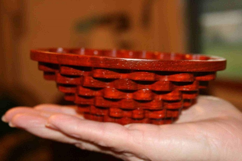

Some 5 years ago I was showing off this project. It was a special request from my daughter in law. She saw a bigger one I had made but wanted on smaller. A customer ask me how I did it and I told him it cut it on my scroll saw. He said "You know that's not real woodworking your just following the lines of a pattern"
So I showed him the picture of the footed candy disk ( the picture above my name) I also made and ask him if this was more like real woodworking. He said "Yes a nice turning, that real woodworking it takes talent to do that" He was very surprised to learn that it too was made with a scroll saw and a bowl sander. He changed this mind about scroll sawing being real woodworking. He saw me the other day and told me he how owns a scroll saw and lovers working on it.

It takes a lot of talent to "follow the lines of a pattern". I hereby label that customer a jerk. That is a nice scrolled bowl, very nice real woodworking!

Is the footed candy dish primarily a series of larger and larger concentric circles?

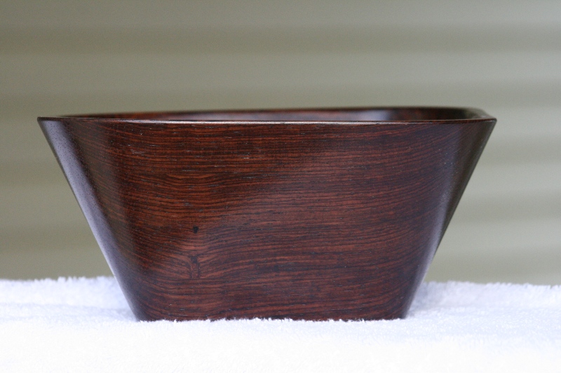

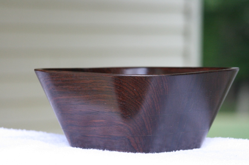

Thanks for all the comments. The bowl is cut from rings that are cut at an 40 deg. angle left side of the table down. It was make from a bamboo cutting board that I cut the lighter end parts off and the rest in a octagon. Then I glued the lighter parts to the octagon two pieces at a time and trimmed to match the octagon angle. The pattern are in a book called " Wooden Bowls form the Scroll Saw by Carole Rothman. The book has a lot of great projects from very simple to complex. You'll need a bowl sander that can mount in a drill press to sand in sides and you can use a bench top belt sander to for the out side. They are a lot of fun to make and you may even learn to enjoy sanding, with these bowls if like opening a gift you sand away the rough rings to find a beautiful bowl or dish inside. The book by Carole is well worth the money. I'll post some other pictures of projects I've made from the book when I can find them.

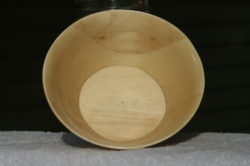

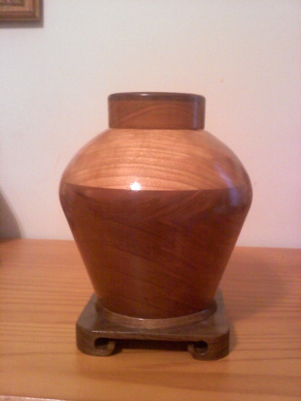

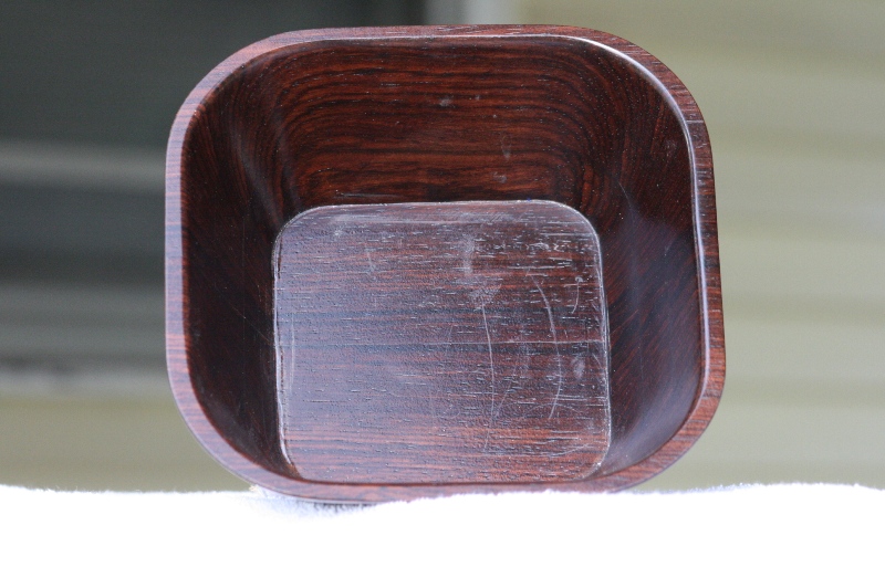

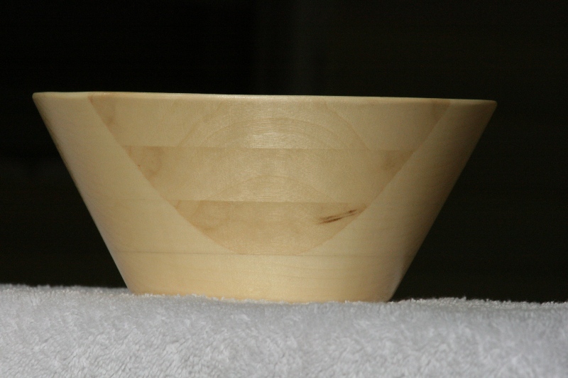

This is a project called a Ginger Jar. It was made for cherry with a base of walnut. This project too about 2 hours to sand. The small light colored bowl was made from aspen and was one of the first bowls I made form the book. The larger bowl was made for cocobolo. The piece I had was to small to get a bowl out of so I had to do a glue up. This was a hard project to cut and sand but worth the effort. Any and all comments are welcome.
