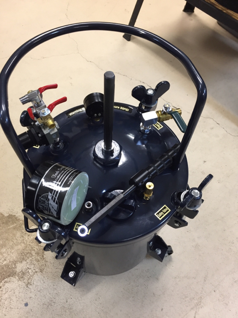

5gal pot, Magic Skew and trade secret wax all arrived today.

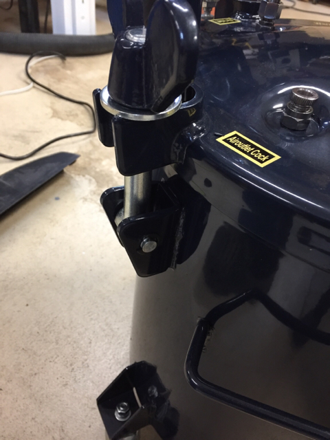

That one is (obviously) the California Air Tools 5 gallon. One of the keys I was looking for was interior room for non-blank related ideas we have for the resin. The tank is actually nicer than I expected. At around $200 it is technically twice the price of the HF but far more than twice the tank. The lid clamp design is much better.

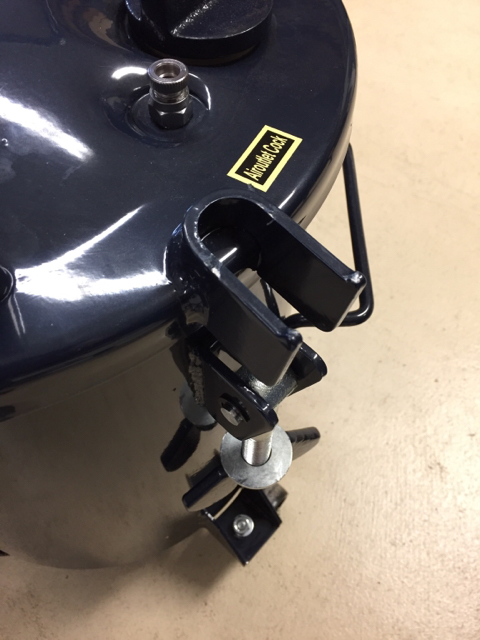

Jay, take a closer look at the clamps for the lid on this pot. Should made you feel better. Out of the box I began to run it up and it popped of at 45psi. Adjusted the safety valve as I continued to run it up. Lid says maximum working pressure 90psi. At 90psi the seal began to leak a little. My compressor gauges both read 105. I set the relief for 85psi, the pot regulator for 80 psi and it only lost a little over 1 lb in an hour at 80 psi. I then removed the paint tube and agitator, added a filter/water separator. Will get a 5/8 bolt tomorrow to plug the agitator hole, tighten fittings and see how it does.

I thought it was a California Air Tools but I was too lazy to look it up. The clamps were exactly what I was looking at, those alone make it worth the step up in price from the HF. Any hiccups converting it for casting or is at easy as the HF?

5/8 x 3.5 galvanized bolt, two rubber washers, two flat washers and self locking nylon insert nut plugged the hole from the mixer fine. I left the two O-rings in from the shaft and it felt like they were snug enough they may have sealed against the bolt shank, but went ahead and used the rubber washers, too. Had to do some repairs to my old water separator, as it was leaking as well as a 90 into the manifold.
Ran it up to 80lbs, closed everything off and let it sit. 5.5 hours later it was at 78.5 lbs so pretty happy.
If you buy or have a 5/8 bolt, nut and the washers you could easily do the conversion in 5 minutes.
