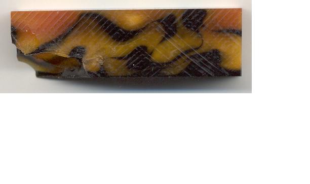

I don't have a pic but one blew up on me because I didn't tighten the vise enough. The bit snagged the blank as it was exiting and the blank slid all the way to the top of the drill bit and almost shattered into 2 pieces!!! [B)][:0]
