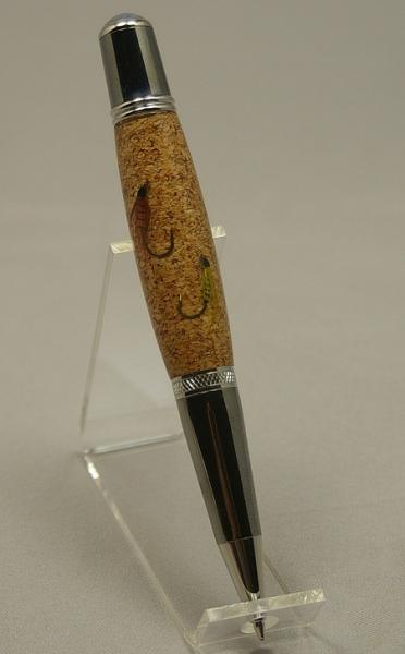

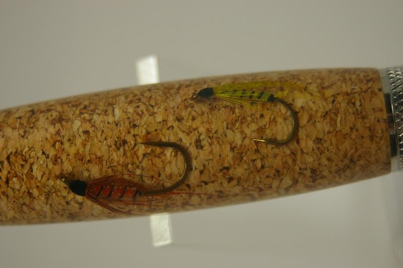

Been trying to make this one work and finally got "prototype #1" to a completed stage. I hope to see some improvements on this (that I can steal back!) from you all! I have a couple more ideas to try over the next week or two...please share if you try anything!
These are 12 and 14 size hooks tied by a gent I met at a show a few months back...he has been making "flatter" flies for me to try out and we finally got one bubble free and still looking like a fly! The cork is craft sheets, almost paper thin and shrinks slightly when cast (at least in Alumilite!).

this is what I was talking about at the show Saturday...now I need Fly Rod clip!

need to turn the eye of the hook 90deg for a flatter profile (pen is much too fat as it sits)
flatter feathers are better...I have a couple of wing feather flies that I was saving until I was sure this would work....they're next... "one-sided" flies work better, but you lose depth.
also playing with some bamboo for background...need to look at some rod pics for more ideas!

I visited with Jon yesterday and got a chance to hold and look at this pen up close and personal. Let me tell you, it's even more impressive when you hold it. The cork sheet he is using is INCREDIBLY thin. 1/32"...maybe 1/16" thick, Jon? It's so thin that there are gaps in the cells in the cork. Because of this, you can see "flashes" of the brass underneath. Jon says that to some pen purists, this is a flaw. Not for me. The cork with the brass showing through reminds me of a clear river's bed--like seeing mica or iron pyrite among the rocks, which just adds to the illusion of the flies swimming through water.
