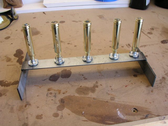

This is a small steel powder coating rack that I welded up for a small toaster oven that i use for powder coating.

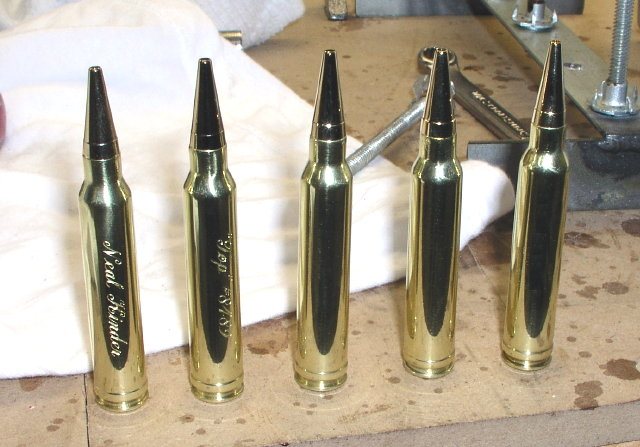

Here are (5) 300 win mags polished and ready to be coated. 2 of them are engraved.

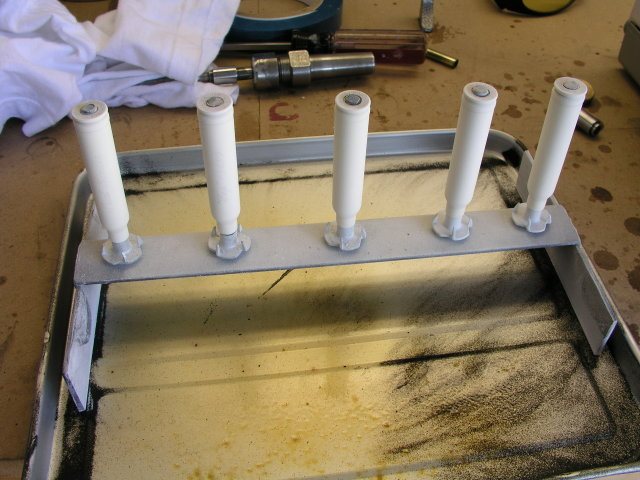

Here they are powdered and ready to bake:

Thanks guys,
Frank. That is correct. Just powdercoat right over the top of it. The powder flows and cures into the engraving. I will take some better photos of the finished pens with the engraving when I get come time to make the upper barrels.

Thanks. It is very easy to do. I would love a laser engraver too, but I don't want the extra car payment! Also, the metals have to be engraved with the old school style engraver from what I have been told.

Thanks. Really there is not much needed. I have the Eastwood powder gun. I checked out the HF gun, but liked the features of the Eastwood better. It is about 100 bucks. If you have a compressor, that is the biggest cost. You only need about 8 psi to run the gun. You will also need an oven. I bought a 30 dollar toaster oven for my pen parts with a pretty large interior dimension. Then you need some sort of wire or metal rack. The parts have to be electrically charged. You simply place the metal parts on the metal rack. This allows you to place the charge on the rack and not directly to each part. To get started, some simple wire or bent up coat hanger will work fine. Just make a rack and attach the alligator lead that comes with the transformer and gun.

The PC is clear. I have several colors also. If done properly, it can be almost invisible to a bit cloudy if done too thick.
