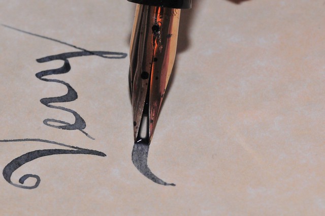

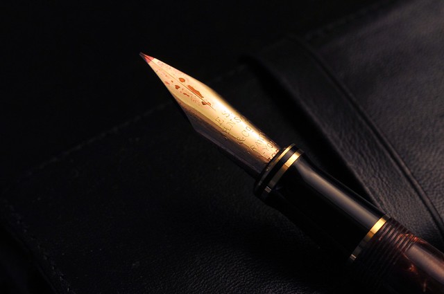

You can put dip nibs in a fountain pen but they will rust out pretty quickly. Some of the nicer ones will last longer. If you can find some vintage gold dip nibs then you'll be set like a king.
Gold dip nib in a modern Parker Duofold, from FPN
Dip Pen Nib In A Fountain Pen? - The Fountain Pen Network
