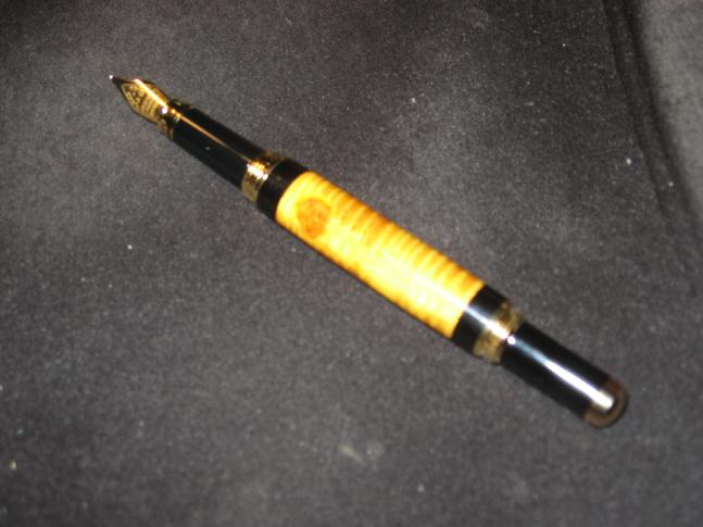

A Woodcraft Classic American Screw Cap Fountain Pen has started to leak after about six months. He says its coming out around the goldring (see lousy photo) on the nib housing. Not sure if it's in front or back and he has the pen. I've never taken one apart, but from what I've researched here, there are no orings or such it's just the press fit of of the feeder and nib section into the feeder housing.
Any tips or suggestions before I tear it apart? I can give him an assembly off a new pen or gut a roller ball for him but would prefer to fix it.
Thanks in advance for the info.

Read all of Lou's great stuff. Talked to the owner of the pen and it's coming through at the joint between the trim ring and the tip of the nib housing. I'm going to have him clean it and reseat the feed.

Ed, wouldn't that problem cause it to leak between the pen boddy and nib? He get ink on his finger tips where he hold the pen while writing. But I'll try anything...Thanks

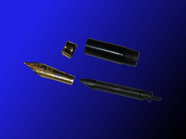

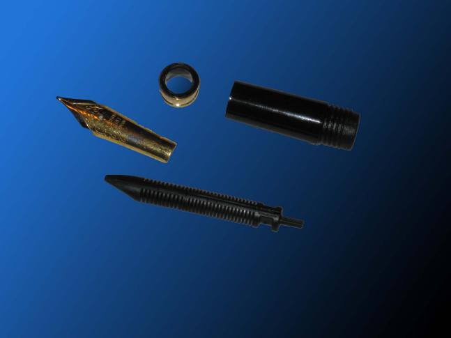

Got the pen from it's owner today....Wiggled out the nib an feeder.....Found the real problem...:frown:...Glad I'd carried another fountain pen I could cannibalize...I'm thinking it must have been dropped.:confused:
Thanks for all the suggestions.....
Vic

Mr Vic
Aug 11, 2008
1,865
Falcon, CO
Jeff, Look at the first picture. The gold ring has a black ring on the inside. That black ring is the top of the housing and should be one piece. It has sheared just below the rim.

Hmmm... Not sold on it being dropped (1st rule of fountain pens, a pen dropped without a cap will always fall nib first) I think that it might of been from screwing the section back into the pen after a refill. if he held it there when tightening the section in the pen, it may of sheared.
