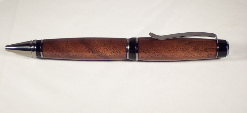

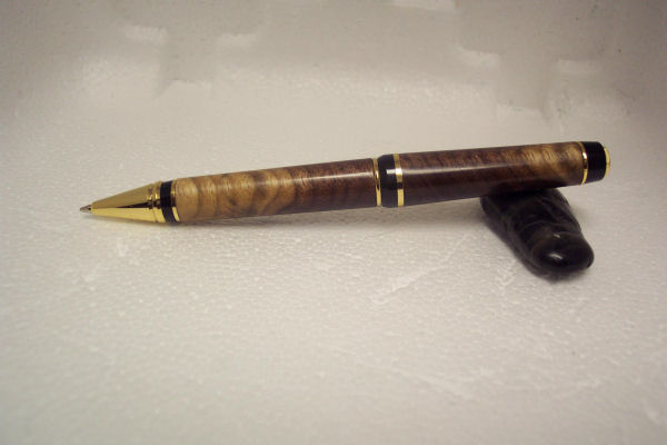

Welcome to the group. A good bunch here and you can nearly always get answers to any questions. Can't help you with the UK suppliers but as for the walnut you have lots of don't give up it makes great pens. Here are a couple I did in walnut, one is cross cut at 90 deg. to the grain and the other is at about 45 deg. If you have lots experiment, if you don't like what you get turn it down to the brass tube and start over you are not out anything but some practice time.
