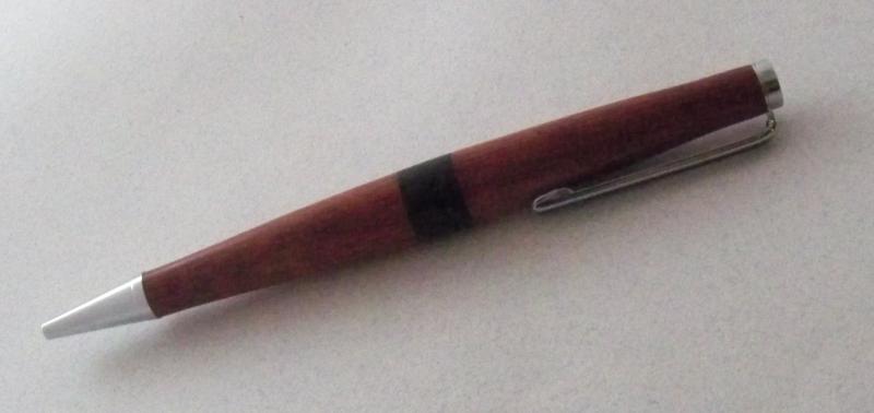

what is the wood and do you have something that would look nice next to it? You could add a piece of wood to the end. We had to do this today with a new penmaker I was teaching. She ran out of time to place the tube into the Bloodwood blank and the was a 3/8" length of tubing sticking out. We took a short piece of ebony (5/8") drilled it and squared both glue areas and glued it on. On her slimline she had a Xlg Ebony centerband.
It was a cool custom adaptation (although accidental).

This is the pen my student made after the CA set before she was expecting it to. Let me know if you are interested in salvaging your pen this way.
